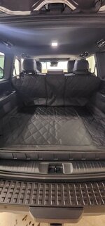

Found adequate covers for the back seats and cargo area/seat backs on Amazon.
Went with this for the rear seats in regular size: Rear Seat Cover
And this for the cargo area: Cargo Cover
I like that the cargo liner has a bumper protector.
The split nature of the seat cover helps when folding seats up and down... in this case you'll need to leave the narrower side unzipped.
These are not perfect custom solutions but they appear to be well made and tough enough for dog's paws and granddaughters' car seats!
