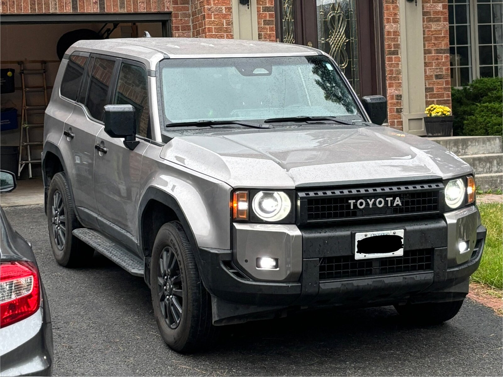

Bought the cover from eBay. This part has 3m double tape and doesn’t require removing the bumper which is exactly why I got it. $120 shipped

There appears to be at least one happy customer of these Chinese fog light covers, per eBay review.
Well I ended up ordering the covers. On inspection, I would say these are excellent quality.

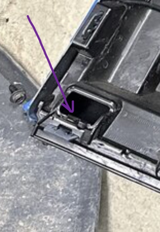

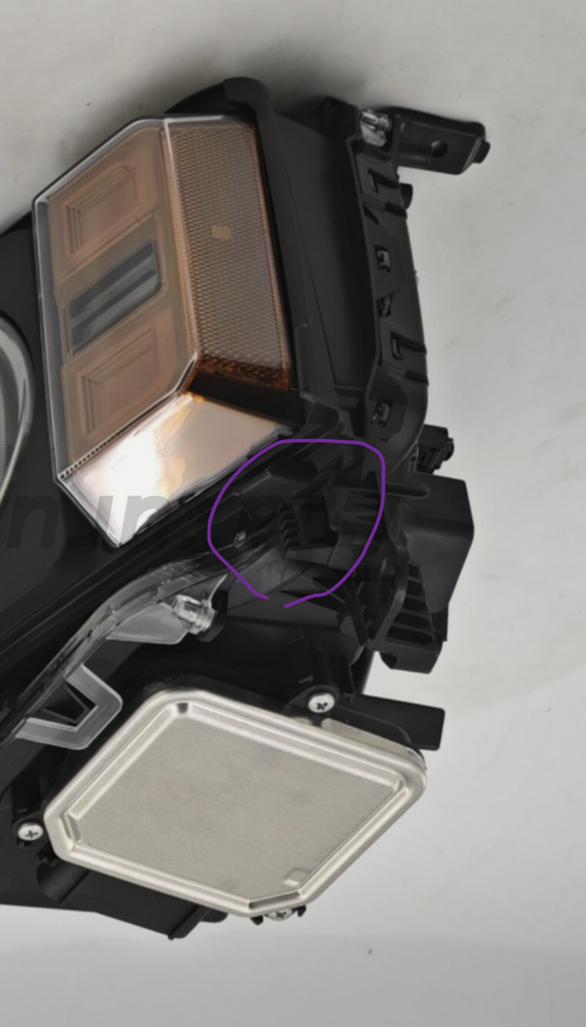

Installation was easy enough, but I managed to break one of the bumper clips which to my astonishment is part of the headlamp assembly. As a result, the bumper doesn’t sit exactly as it should in one corner. I’ll have to see if I can figure out my own fix, because the headlamps are very expensive. Open to suggestions! Photo of the clip below.
Can you post the instructions?
YouTube has a few bumper removal videos that do a good job. I’m not sure what I could have done differently to avoid breaking the clip, however. The only thing I would add is that the “modular” sections of the bumper, including the fog light cover, come off in a specific order because they’re overlapped. The bottom corner panels come off first. As noted a few posts back with the part number, you will need new parking sensor retainers from Toyota.

is the texture difference noticeable? Local body shop is confident there wont be a difference after painting original.
No complaints. Paint match and finish is perfect. I think this route is much cheaper than a body shop. They were $260 USD at the time I purchased.
Update on this, in case anyone else runs into the problem. There is a little plastic tab that can get bent, this is what can prevent the bumper from sitting correctly. I bent it back so it goes into the clip that broke, issue solved.
