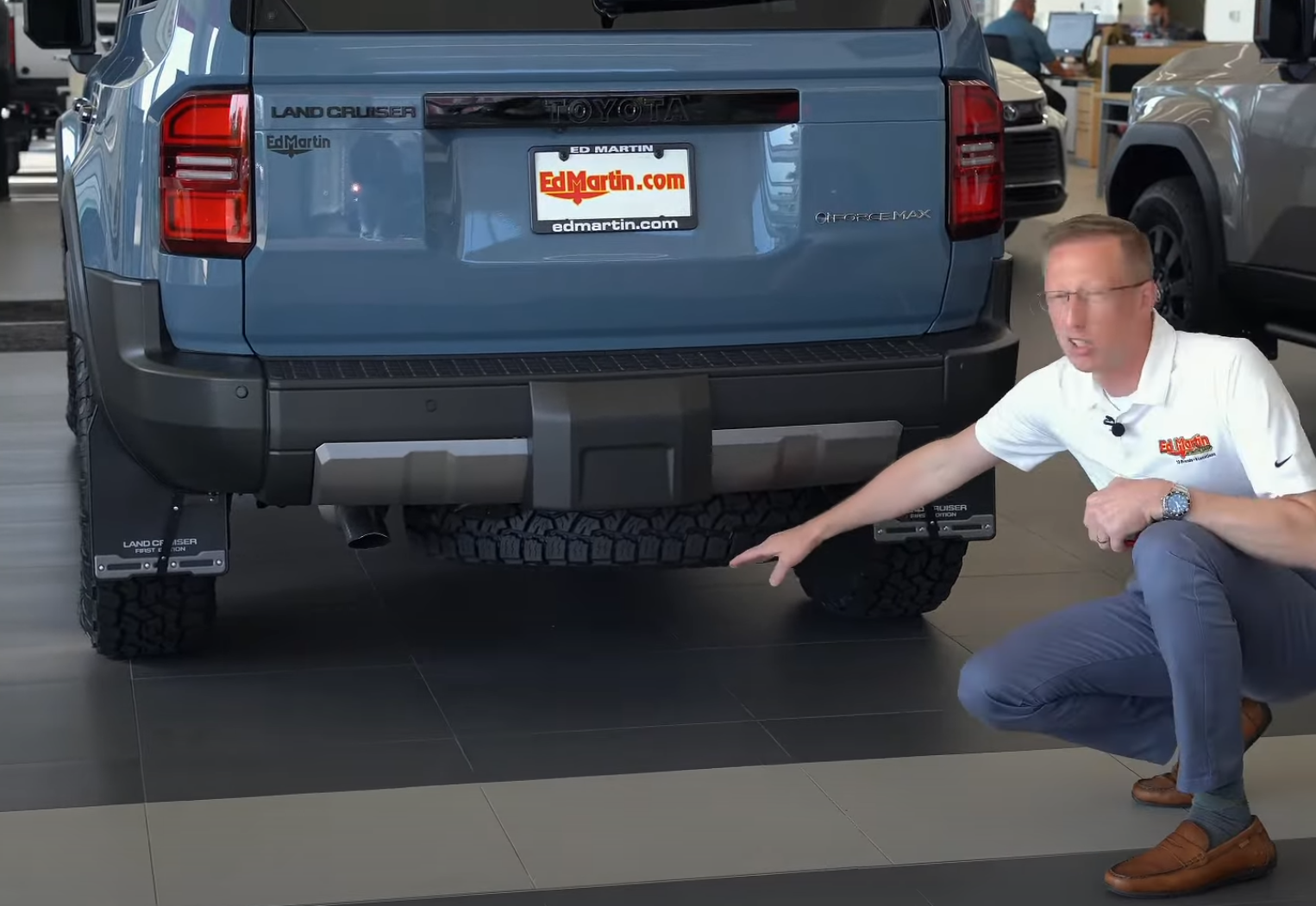

Shopping wheels and spare fitment is a serious consideration. Ran across this. Not sure what they are doing under there (moving it to the side?) but that 34.8" tire is hanging way down and does not look good and presents functionality problems as well.
I am considering options for better fitment by deflating the spare (will have air obviously). Or I am considering just running a mismatched spare to limp out/limp to tire store if necessary.
imo 275/70/18s (33s) are the sweet spot. Less headaches
That’s because 285/70r18 doesn’t fit up there, and they just cranked it til it was tight, not within its enclosure. 275/70r18 fits (tried both at Discount).
