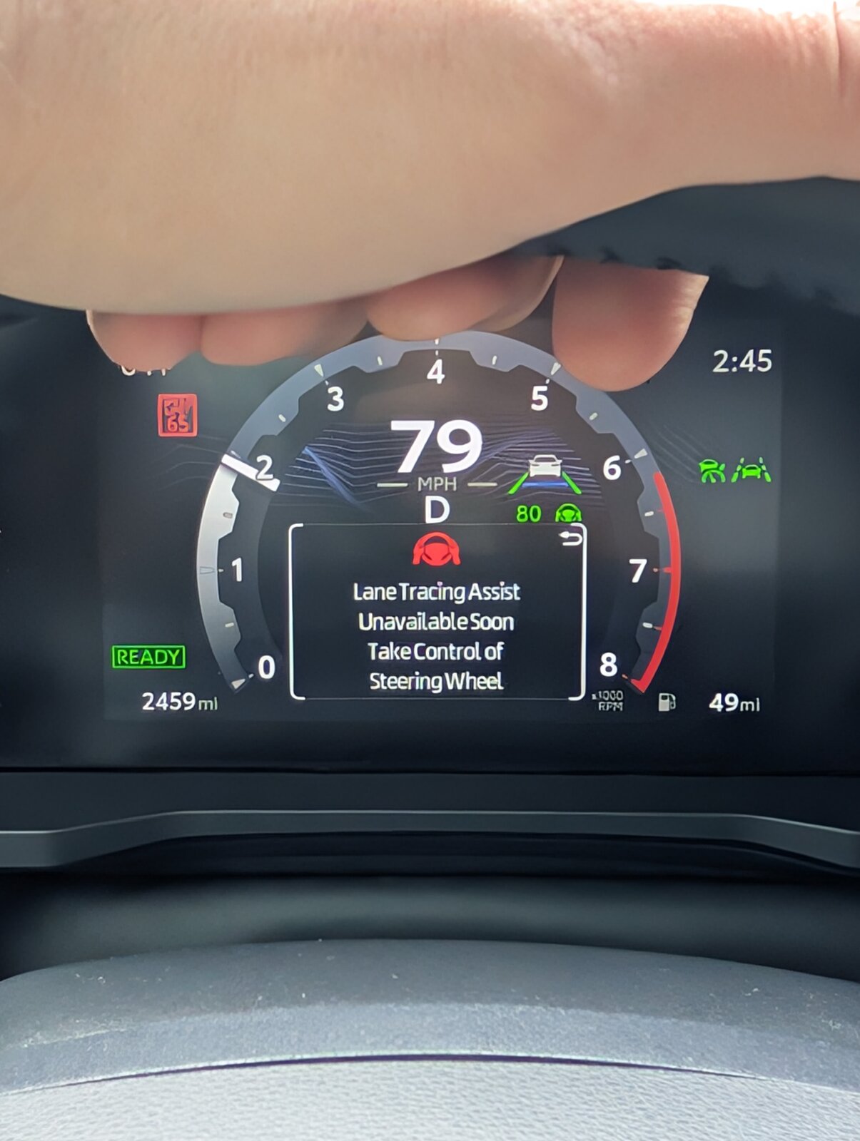

Anyone else find that just holding the wheel isn't enough to keep your LTA happy? Even in a straight stretch of highway I have to continuously wiggle the wheel or else it throws up warnings and stops working. Makes the feature pretty much worthless. Is mine broken or does LTA just blow this bad?

I'm getting this error that it's about to disable itself every couple minutes as well. It often doesn't actually disable though. I've been using a light touch though because I've been under the impression that the steering wheel used capacitative touch sensing, but it seems like this may not be the case. I have a 1958, so maybe it has a different behavior though it seems unlikely because the steering wheels seem otherwise identical (except telescopic adjust).
There are very conflicting reports here, with some never seeing this error even with just lightly touching the steering wheel, and others noticing they need to apply pressure or torque to it. It makes it hard to know what's going on.

1. Maybe (defects are possible), but more likely in cases where it's not working the hands on the wheel are not applying steering force, just pressure, which is not what the sensor is looking for.
2. Definitely not capacitive touch on any trim - the system is not checking for "hands on the wheel". Requires driver to apply a light turning force (torque) to the steering wheel even when the car is tracking straight.
3. Correct, though you don't need to hold it firmly (though that likely results in the necessary torque, inadvertently). It's "directional" pressure if you want to call it that.
I'll add I wish it was capacitive, or that it only required torque during turns or when the camera can't see your eyes on the road. Unfortunately, it's like many other systems that requires a little bit of torque on the wheel.
