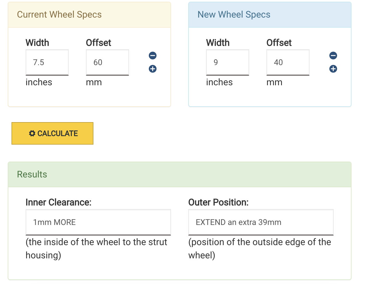

Here is a link to a nice offset calculator so you can compare different wheels (both width and offset are important because offset is measured from the wheel center.)
My stock wheels are 7.5" +60 offset. So, I've compared them to things like 8.5" +35 (Method 703)and 9" +40 (Method 708 HD). The results can be surprising! On the screenshot below, you'll see that the 9" +40 will extend out an extra 39 mm past my current rims (1.54" - take 39 mm and divide by 25.4 to convert to inches.) I'll have to measure my current wheels to determine where they sit relative to the fenders.
