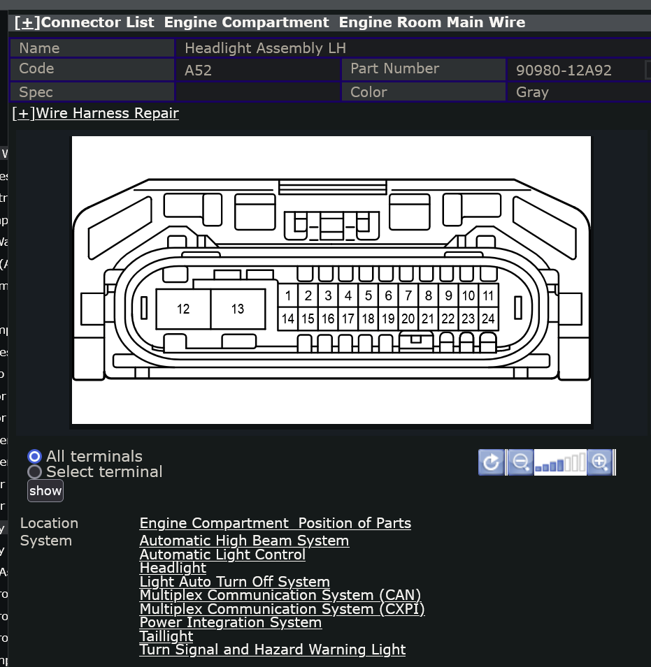

Wiring connector for Round vs square headlights is identical - should be no problem to swap them. There's only one part number for the headlight connector.

My dealership parts dept confirms what you said, but they say the harness has a different part number between FE (round) and LC trim (square). However I’ll be testing out the swap when my vehicle gets out of port and is delivered, then I’ll report back here.
