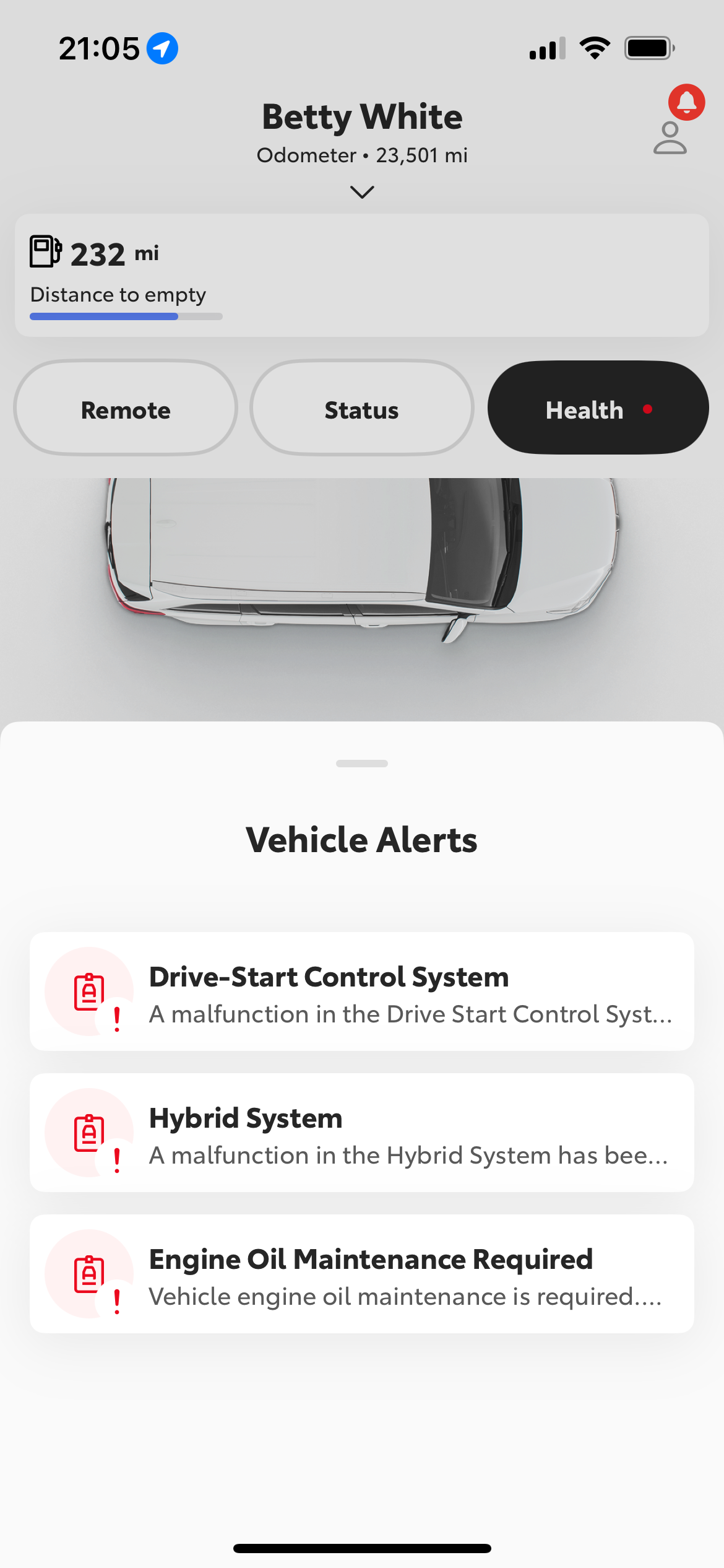

The following just popped up as I pulled into the driveway tonight after church. Nothing weird was happening. My only modification are some ditch lights wired directly into 12V power and a dedicated switch for the last 6 months.

Interesting. Well I’m bringing it by Toyota in the morning. I havent attempted to drive it at all since the messages popped up. Will it allow me to drive with those errors.

I really appreciate the feedback. I did drive it up and down my block just to make sure it’ll drive in the morning. Ran fine. Used the turbo and the electric motor. Even switch to electric only at one point. Still all the error messages.

So weird outcome. They said the battery tested fine. They found remnants of some kind of liquid underneath the shifter boot. Like someone spilled something on the shifter, and it leaked through. They said it caused a short that sent the computer into some kind of protective mode. They cleaned it up, and everything is back to normal.
That said, I am the only one who drives my 250--I have never spilled anything in it, much less on the shifter. So who knows?
