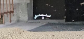

Hello, guys.
Every time I start the vehicle I can see another hud type for 1 second. After that it changes for a usual one. The picture is attached. Sorry for the quality - not easy to catch that moment and focus.
What is that and how to enable this type of display?

That displays the tachometer above the speed, so far the only way I have found to get it back is to turn off a bunch of driver assistance stuff (adaptive cruise, land departure assistance, maybe some others).

Tried to turn all assistants off - still not coming out...
So there's only a tachometer added? And all other information is still there?
Here’s a link to a YouTube video where this guy turns off certain features to get the tachometer or the hybrid system to come up on the HUD of a Lexus. Try turning off the features that he’s talking about and maybe you’ll see it.
On mine I need to set cruise to standard (not adaptive), turn lane departure off on the steering wheel, and turn off LDA in the menu on gauge cluster. See pics of my HUD before and after (also highlights the ghosting I am seeing):

Worked. Thanks. Nothing interesting..)
