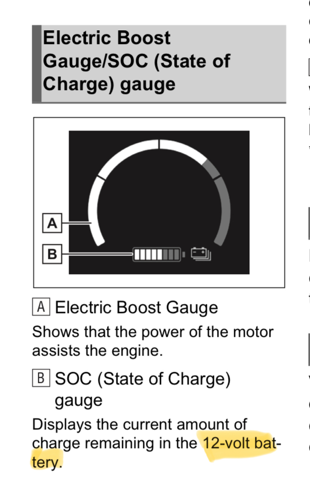

Mine does the same always 3-4 bars. I was reading the manual and it states that the bar gauge (not the boost) is for the 12 volt battery though which wouldn’t be the hybrid battery but rather the normal car battery. That doesn’t seem correct to me.
Seems odd to me you cannot monitor the traction battery (hybrid)but can the 12V battery.
I agree so I looked it up. Traildust is correct.
Yeah. I read and re-read the OM several times last month and finally gave up trying to figure it out beyond the 4 charging options originally listed. I figured I would wit until some smarter than me can explain to me like a 5th grader could understand.

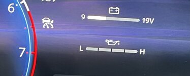

The gauge is between 9v-20v so 3 or 4 bars is right in the normal 12v range.

I agree so I looked it up. Traildust is correct. View attachment 5073
I think the manual is wrong. I definitely saw battery on that gauge to get nearly full with the regular battery gauge staying at 12v.
Image below after I went down a moderately steep hill at low speed.
