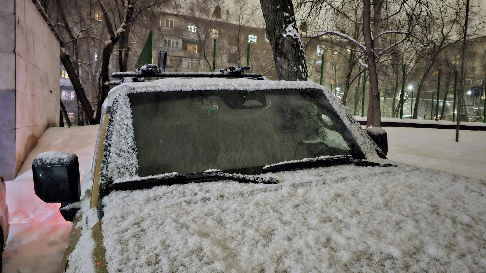

Concerning deicer - not full area of the windshield has the heating elements. Which is really strange. It melts ice perfectly but still keeps some icy areas on the left and right sides.

Does the US LC250 have heat elements in the front windshield?
They do but only where the wipers rest, which is not the best IMO. I've owned 90's Land Rovers with full windshield heating elements that worked x10 better.
I have this same problem with my US LC250 1958 model. It made for some hazardous travel a few days ago during a freezing rain storm. I kept tweaking with the heat settings to put more fan speed on the windshield and turned up temp all the way. Still didnt help. If there is a heating element in the front windshield, I have yet to figure out how to turn it on.
Through the Radio screen
