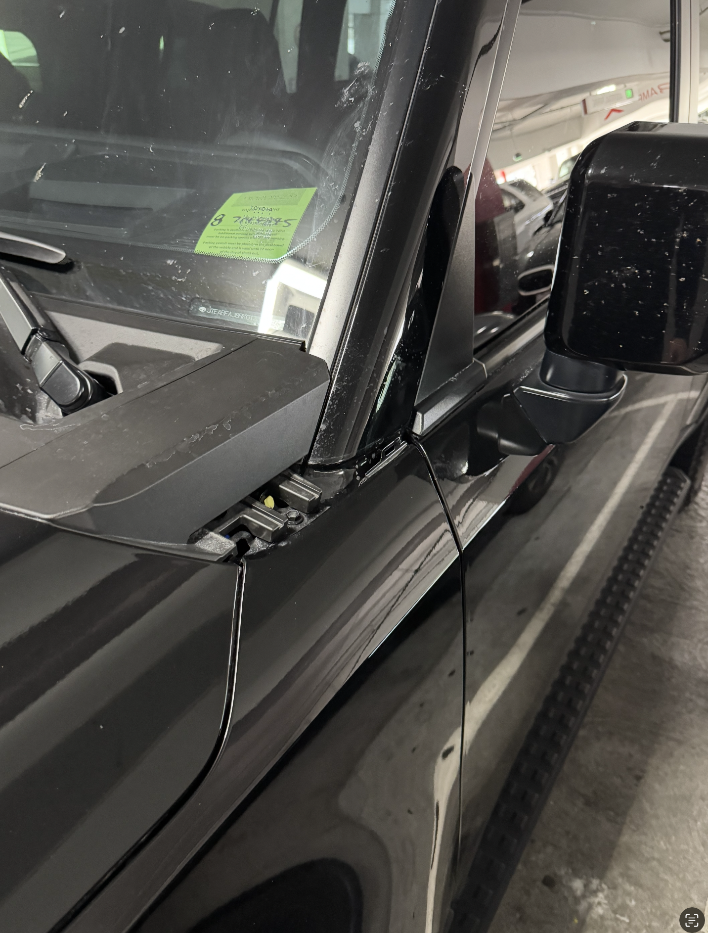

the drivers, front rubber panel flew off randomly when I was on the freeway. The other one seems loose, does anyone know the part #?
I would think the dealer would replace the missing part for you under warranty. It's not exactly a wear part. Thanks for posting.
I took it in, they said its backordered and will LMK when its back in stock
