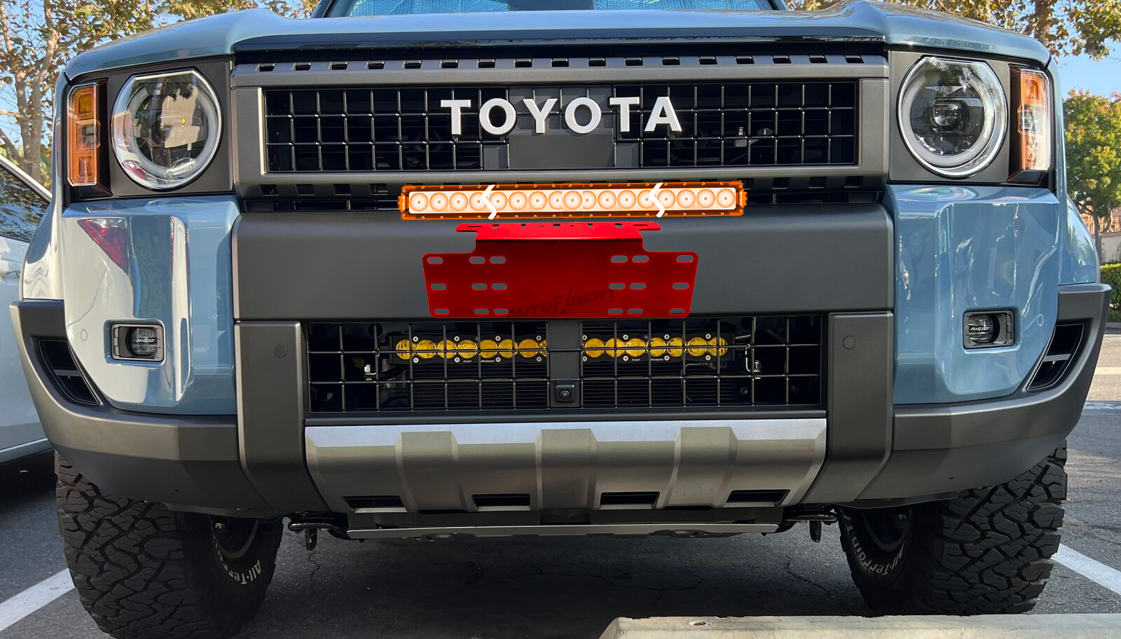

This video I pulled out here for you and hope that it will give you the idea.
Anyone know if you can fit a 30” bar in that spot? I have a 30” Baja Designs lying around and would love to mount that sucker in the lower grille.
M&R 30” Slim Light Bar mounted in upper part of lower grill to give as much airflow to lower grill as possible.
I might be trying something similar this weekend with a 30” light bar. Tried to get M&R to sell me a bracket but they weren’t willing to. For those that have done this, what do you think the optimum distance from the front grille is? In other words, do you recommend recessing the bar or trying to get it as close to the front as possible?
Also wondering if it’s worth waiting for this:
MaximustLC - That new light bar system just looks like too much air flow blockage for me. Remember you pushing air through a turbo intercooler, ac condenser & radiator in just the upper location. Just my opinion. Cool bracket design. You can make your own L brackets for a M&R 30” bar pretty easily.
Regarding the light spacing, no matter your light’s output light field it has to go through a 3/4 to 1” depth set of grill squares whicjph keeps wide angle limited, so really doesn’t matters a whole lot..
Makes sense! I was thinking the brackets would be nice to buy but only doing a single light bar for sure. You’re right, 2 would have to have an impact on cooling I’d think. I don’t need a winch for my use case but sort of like the dv8 front bumper with the 20” cutout too. Great call on the light angles too, I hadn’t really considered the impact on the beam pattern honestly. Hmmm 🤔
