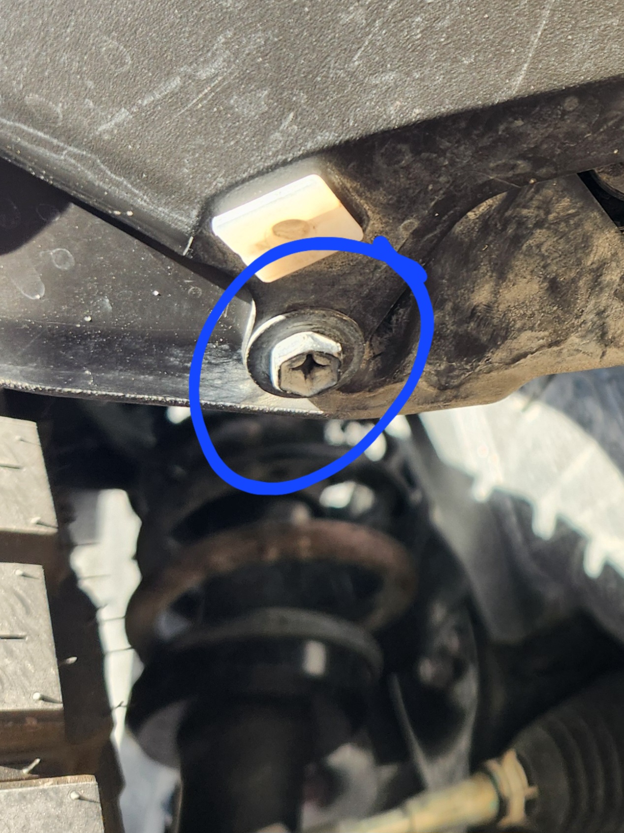

Any chance of reposting the photo? Thanks
This is the one
