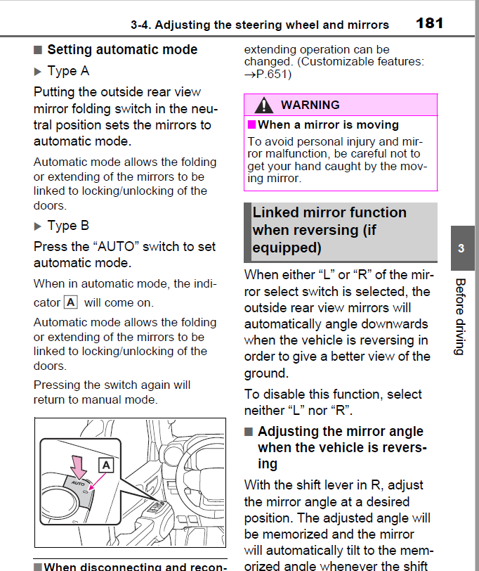

The only way I've been able to get the mirrors to fold in is to use the key fob. Irritating. IMO the mirrors should fold in when the doors are closed whether they are locked or not.
Mine fold in when I use the button on the door handle... When it works. Must be a setting?
I think you are referring to using touch sensor on handle - so touch handle with fob on your person, and it locks as well as mirrors fold in. I use this feature all the time.
To me, it sounds like you are holding onto the handle too long. I have had this happen a few times. It starts to lock but then reverses because with hand still on handle, it thinks you want to unlock.
Try touching for a second and remove your hand and hopefully this simple fix will help.
