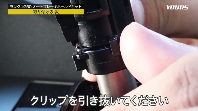

Ok can you help me out here. I got the kit, and these are the instructions that came with it...
Not very confidence boosting. 20 min?
Not very confidence boosting. 20 min?View attachment 56819View attachment 56820View attachment 56821
Those are breakout harnesses..... Unplug OEM and plug each end of the harness into the OEM harness and switch. All the center console trim panels pop off/out. To get the shifter knob off, pull the boot straight down and remove the very thin "C" clip by using a hook tool and pulling it straight forward towards the front bumper. Be careful as it likes to shoot forward and fall into the depths of the console abyss. Everything else pops off with a sharp yank.

Thank you, that is much better than the printed version. Why can't this simply be tuned/coded is beyond me!
For my GX, I didn't need to remove the shifter knob as the I could reach the harness and plug from the side.
Also note that those instructions are for a RHD vehicle, so the install may be a bit different. But yes...I stand by my original comment that it took me 20 min working in a dark subterrenean garage at work.
Did the install today. Video above is super helpful. I confirm the 20-30 minutes to install.
