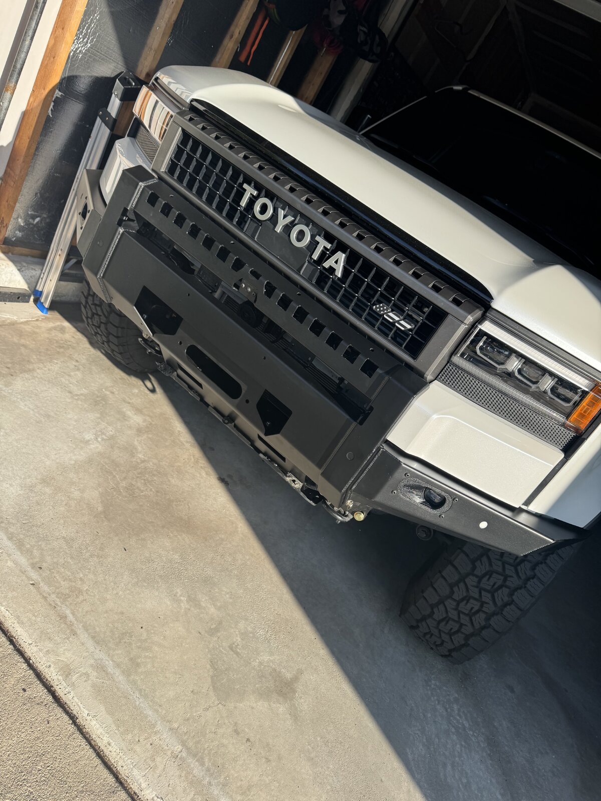

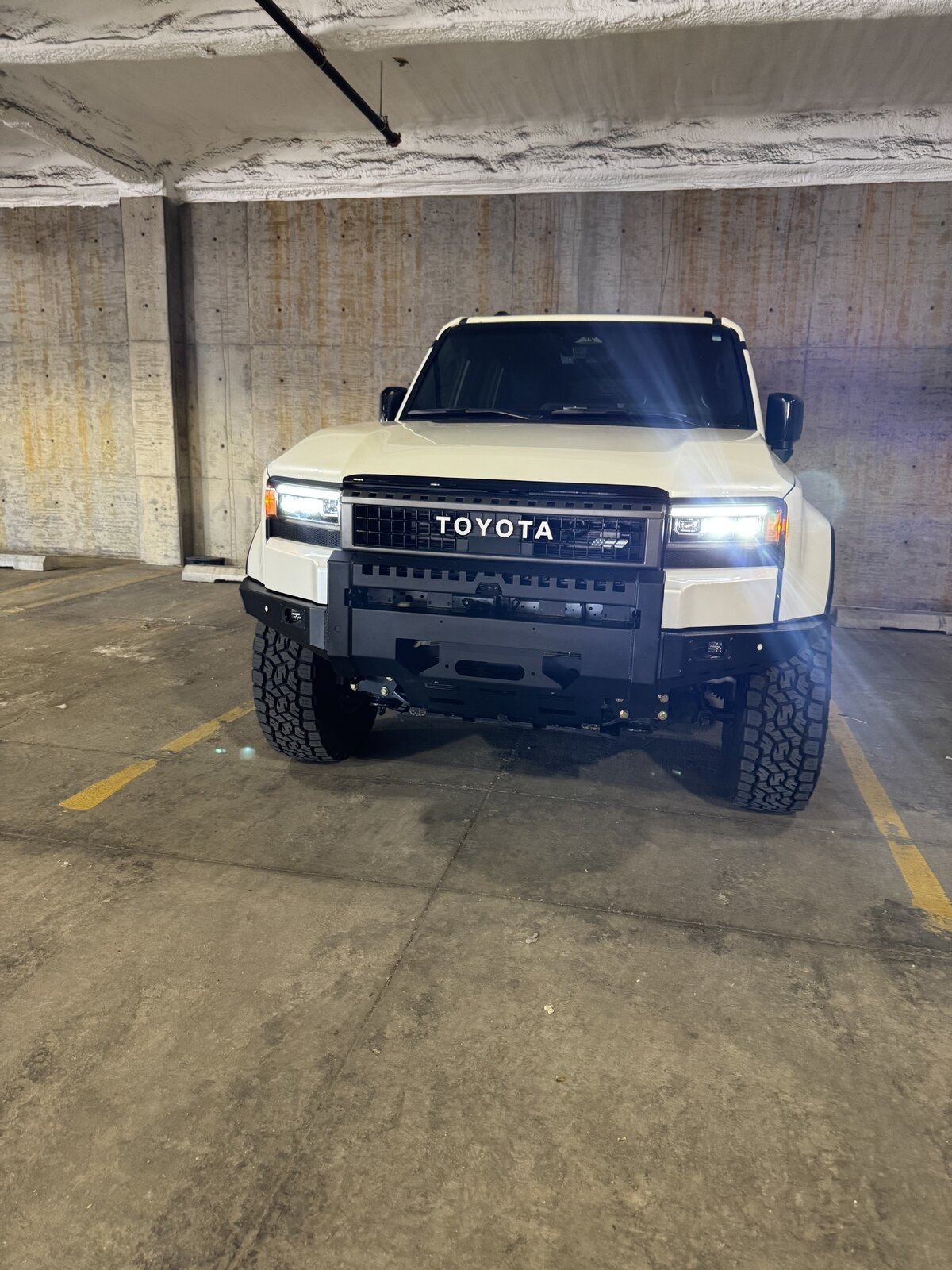

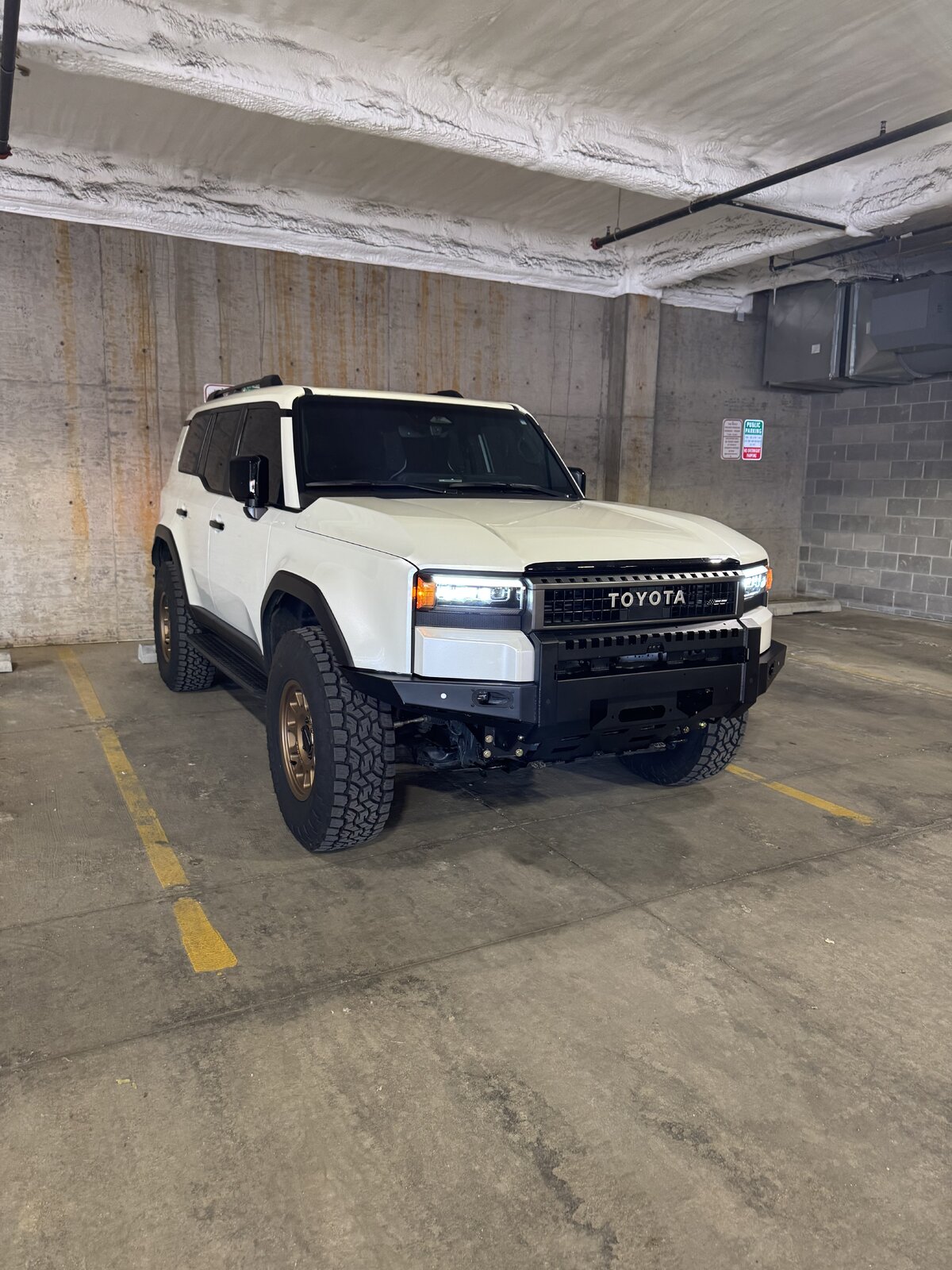

I recently had a Dissent front bumper installed by Mountain Yota’s here in Colorado! This may be the first in Colorado!! I love how tucked it looks and the tire clearance it gives. I also had a Peak Suspension 2.25” up front with 1” in the rear installed with the Method 703’s (+35mm offset 17x8.5) with some Toyo AT3 in 35x11.5x17. I love the way it looks and rides!
Next up is a 30” SAE Rigin Bar in the bumper, Blaze Power Relocation with the Garmin Switch and my ARB dual compressor & Midland mx275 radio installed that I had from my Bronco. I also have a set of RCI full skids and gas tank skid on the way.

Do you have the front CTA or was it relocated? I noticed their Center only bumper does and your bumper doesn’t seem to go as high/require as much cutting as other full bumpers.
I’m not sure what the CTA is? My front camera was relocated but it still has all of the sensors and everything works as normal with no loss of functionality. Dissent only makes one front bumper. They don’t have a center only bumper.
Cross Traffic Alert. The full bumpers like ARB no longer have CTA.
Front RADAR is behind the flat area under the Toyota letters in the upper grill, only other sensors up front for the bumper are the parking sensors.
I had the whole front end apart for my bumper install, I don't think there is a front bumper out that disturbs the upper grille RADAR portion, the ARB may obstruct the RADAR however?
I have both front and rear cross traffic alert, the rear I believe has two RADAR panels in the bumper corners for RCTA and blindspot monitoring.
