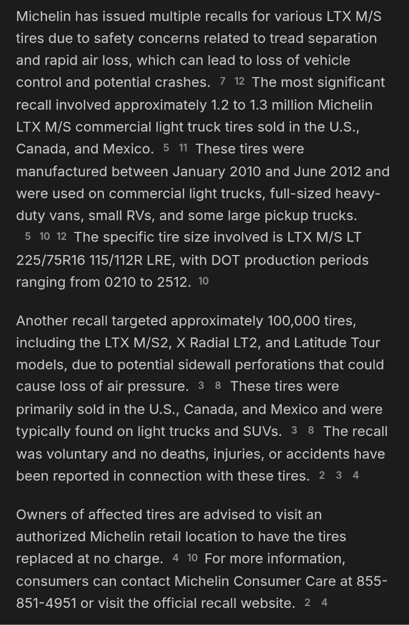

Michelin does not own Pirelli. LTX tires failed on me and michelin would not help because they were 4 years old even though they only had 5k miles on them. My pilots have been awesome i must say.

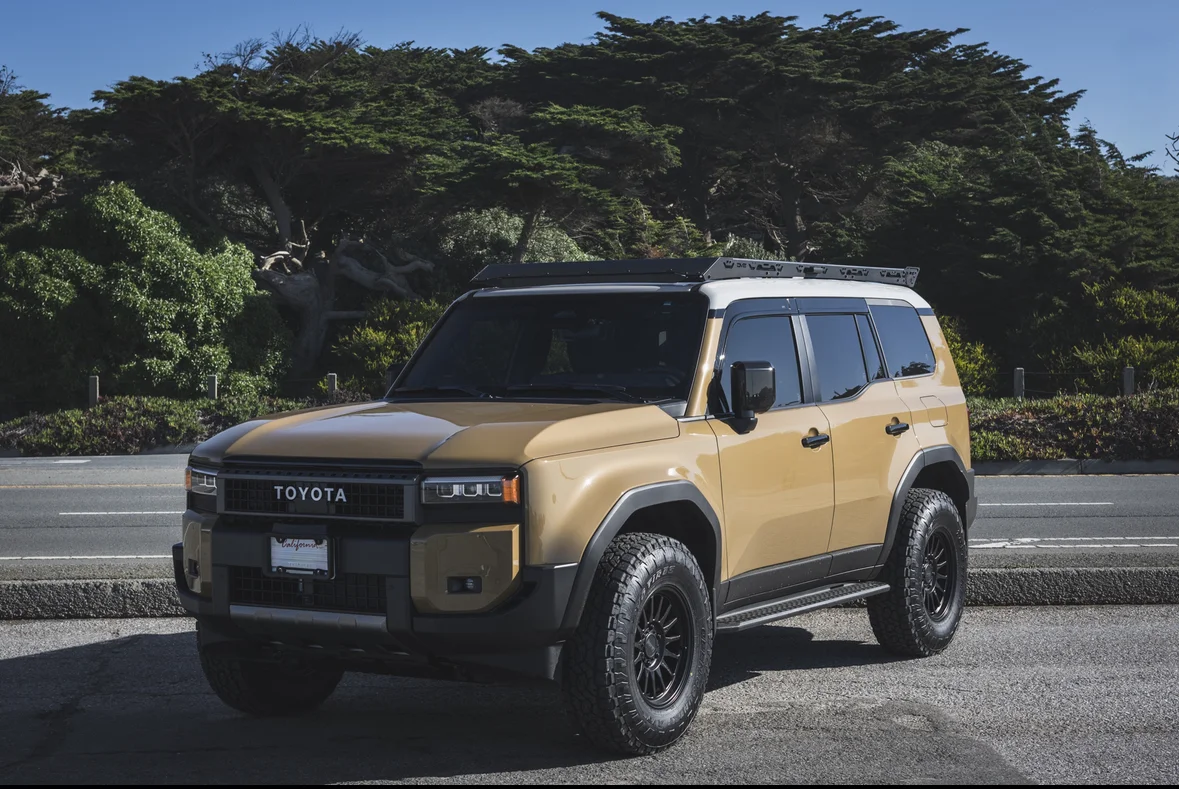

If anyone is still checking this thread, wanted to add that I put (bronze) Method 703 in 17x8.5 with +35mm offset on my LCLC with Toyo Open Country AT3s in 34x10.5r17. I have stock suspension and this wheel/tire combo fits without modification for the full range of motion (as far as I can tell) and in the stock spare location under the truck. I've taken it offroading a bit on some muddy lighter trails and the combo worked fantastically. I love the new look compared to stock.
Set cold PSI to 34, which heats up to 38 after some time on the road. Good ride quality and mileage only dropped from about 22 to about 20.

I love this ratios on this setup. Thanks for the pic. I've got a LC250 on it's way (at the port in CA) and just ordered the Method 703s in 17x8.5 with +35mm and I'm 99% set on the Toyo Open Country AT3s in 34x10.5r17.

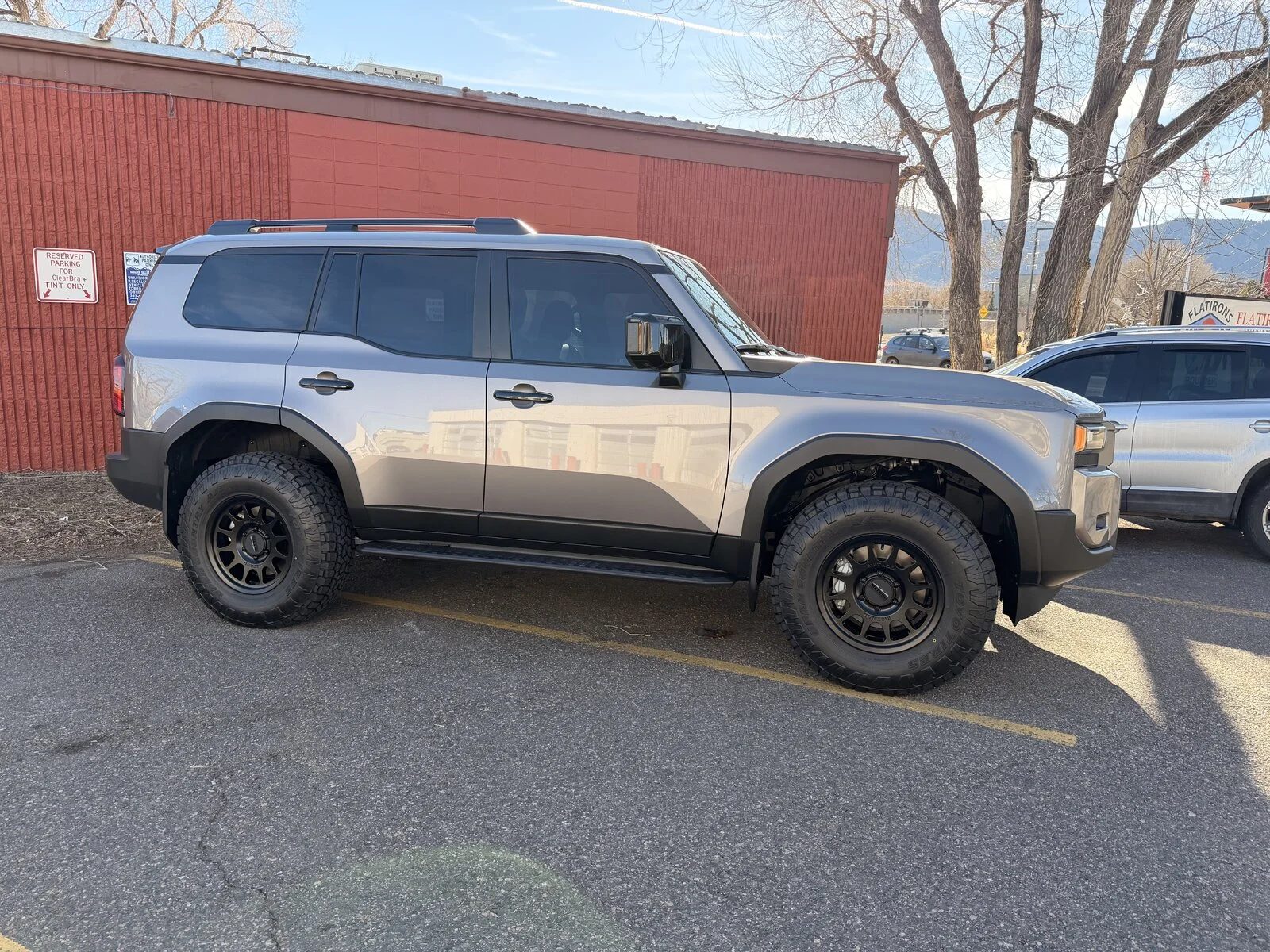

Getting Toyo’s 34/10.5/17 with Icon wheels put on today. 25 offset
