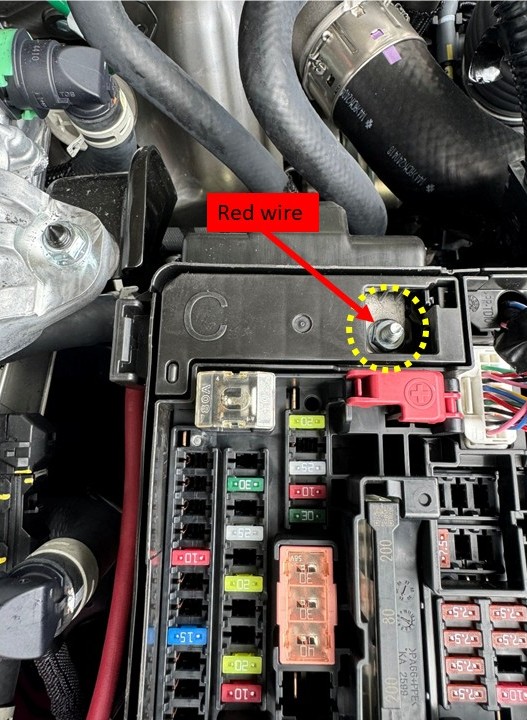

Can you show us (me) where you have it hooked up to? I have a dongle that I want to hook up, under the hood, so that I can just plug my charger into the dongle to charge Miss Daisy.
Can you show us (me) where you have it hooked up to? I have a dongle that I want to hook up, under the hood, so that I can just plug my charger into the dongle to charge Miss Daisy.View attachment 29365
Red wire to the POS stud and the Black wire to any body/fender bolt.
