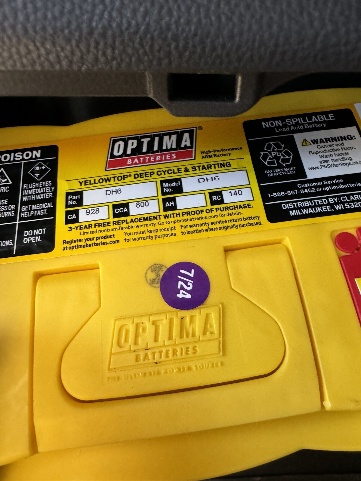

I let the dealer replace the OEM battery and I put the Optima in...... now have a spare battery.
It's plug in play, but a plain to wiggle the battery out and back in.
Which optima btw? The vehicle battery finder in their site does not list one for ours
Optima DH6
What a pain that was! but it fit.......
