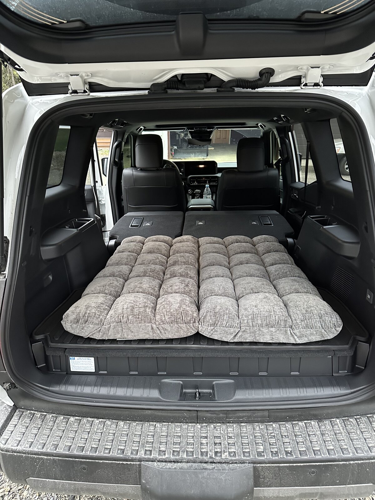

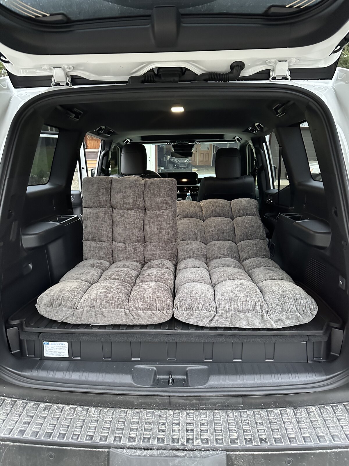

I just used this folding gymnastics mat. I cut off one third of it, so it's only two panels. I thought I would need two of these stacked to make 4" platform but it turns out that one 2" is perfectly comfortable. Folds up in half when I'm not using it.
I did shorten one of the panels by a few inches (cut it open, cut the foam, the re-sewed it...no I don't know how to sew, but it was easy) so that it fits perfectly when folded open.
I've got a nice, high R value, Exped megamat that I unroll on top of it.

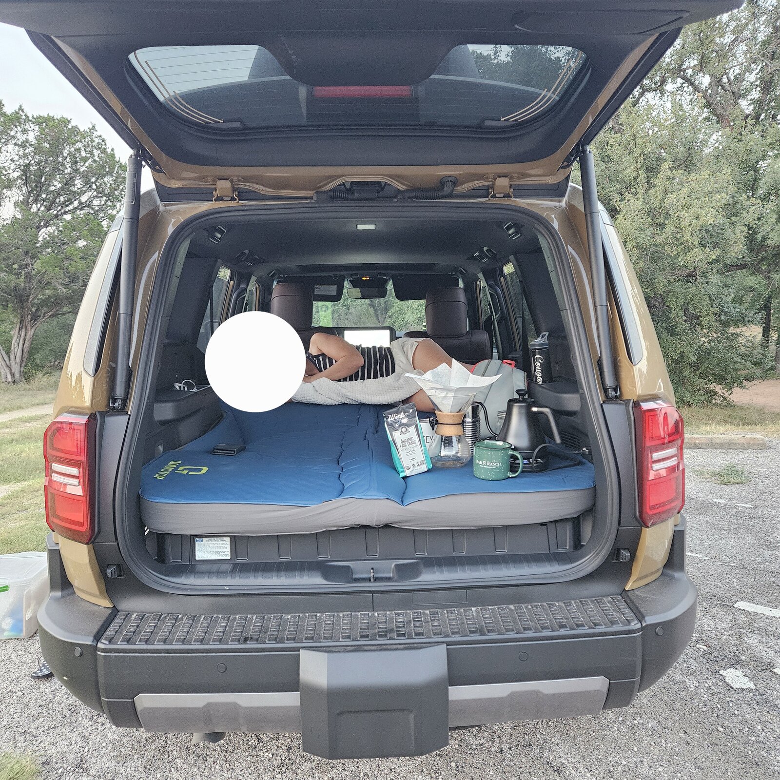

No i think they are 4 inches but I could be wrong. sits pretty even with the 2nd row when folded, ill try to get a pic of that soon. This photo was just a test so i hadnt pumped them up that much. and the mattress looks a bit more slanted only because I also had this headrest on I was testing from AMZN. I just hadnt adjusted it to the right length.

That's what I thought also, so I bought two, but I ended up only needing one. Adding the two inches was enough, I don't feel any lump in my back or anything when I lay flat. Kind of surprised me.

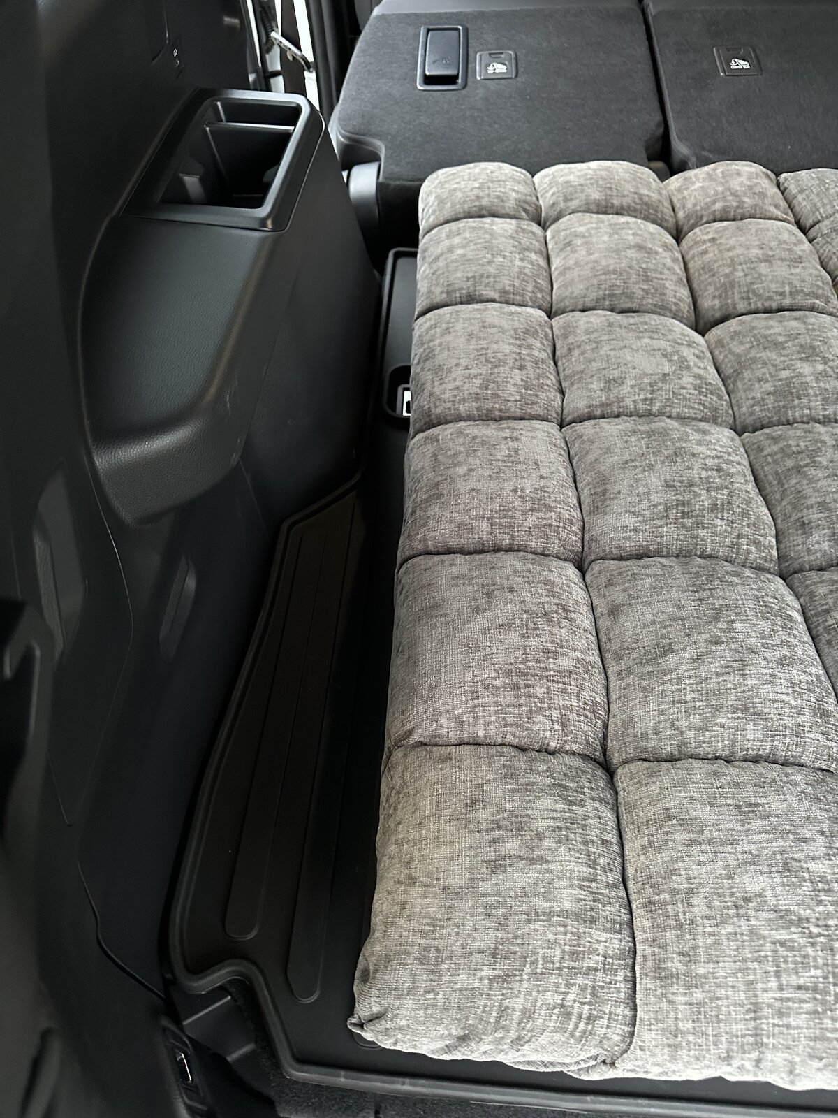

I bought the same pad, very comfortable. As someone else already pointed out, I put a small blanket in between to fill the gap between the back seats and the floor. My wife doesn't need one as she's shorter. We enjoy the experience.

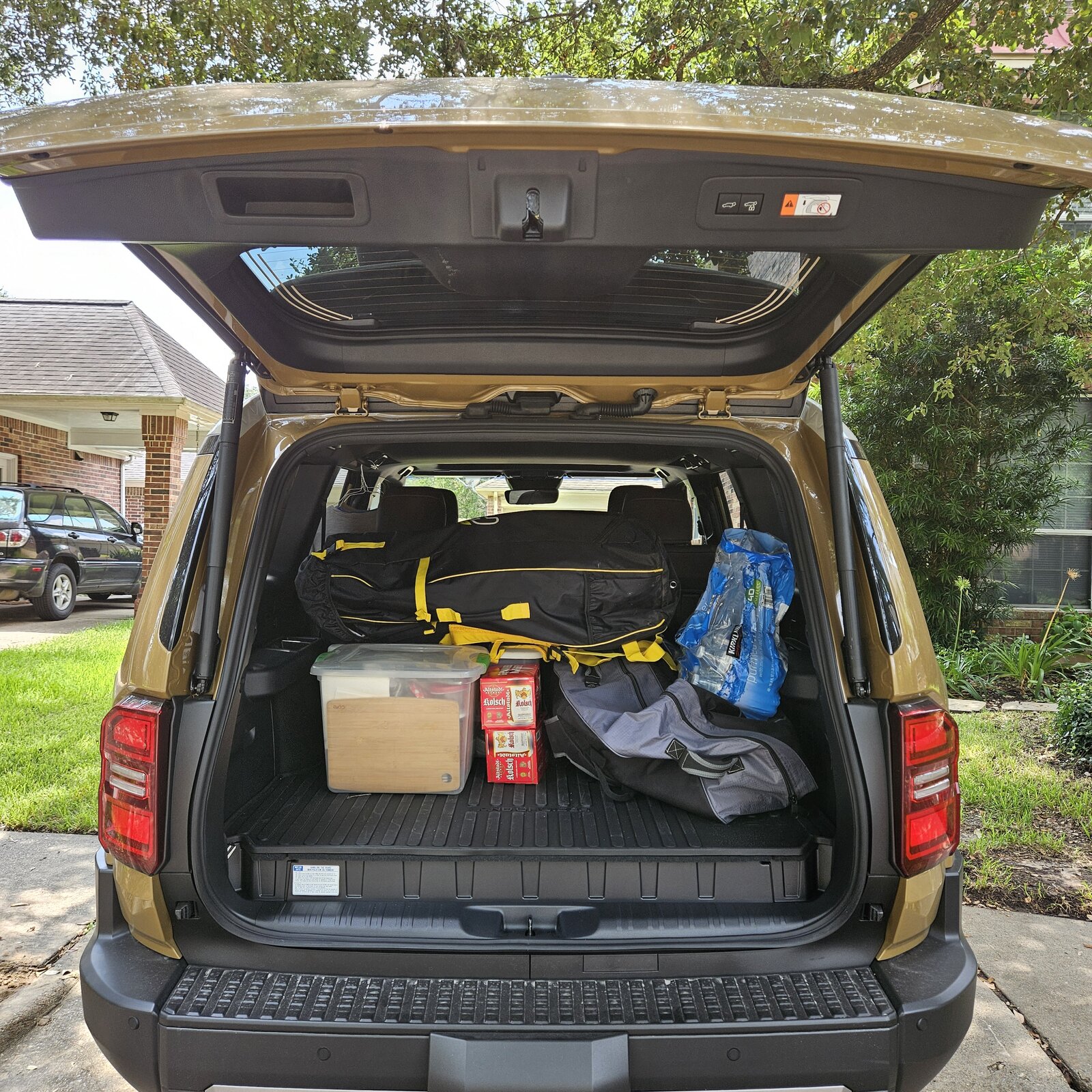

I also have a Thule tub which stores the sleeping pad, 2 camping chairs, and all my camping accessories. For pan and pots, cooking ingredients I store them in 2 plastic containers and put them in the back area together with 2 paddle boards. It works for me.
