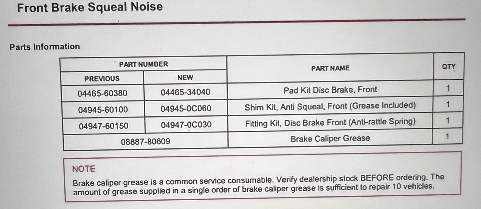

That is the bulletin and the new part numbers for the fix

Would love to know how the shims differ....... They typically just clip over the pads. onder if the stock shims have too much tolerance so when you go into reverse they are shifting on the pad.
