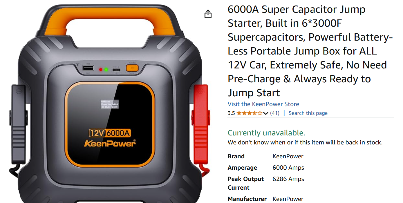

I have this one, should it ever break, I'll get another just like it. I was unsure at 1st due to the cost, but well worth it IMO.
Interesting. Seems it would be great at delivering a big jolt for turning a starter motor, but I wonder if it's overkill for our hybrid LCs, or maybe just a different animal. I also wonder if you're out in the woods and everything is dead as a doornail, could it leave you stranded?
If I'm understanding it correctly, it doesn't "hold" a charge over long periods but can take a charge from a relatively dead battery.. still leaves me wondering about a completely drained battery without another car around to charge the capacitors in it. Seems like more of around the garage or around other vehicle solution, maybe.
From my cursory electronic understanding, capacitors drain charge pretty quickly, but are meant to deliver quick transient voltages.

You have a good point about every power source being dead as a doornail. To me it's no different than having a dead jump box. I have always had battery type jump boxes, seems like whenever you really needed it, the battery needed charging. I replaced several of them because the internal battery quit taking a charge etc....... With the capacitor style there is no battery to keep charged or go bad.......... mine has stored a charge for at least 2 months and can be charged from just about any DC power source as all you're really doing is charging the capacitors. I assume there's a regulator involved during the discharge cycle to slow the rate of discharge. I know for a fact that a 12v battery that has 5 volts remaining will charge the capacitors, it did take pressing the charge button twice (still haven't got it all figured out the charge cycle procedure) it started my buddy's truck without a hitch. It's started my LC, well allowed the computers to fire up, on several occasions (before I installed the solar charger). At some point I do plan on doing a test to see if the solar charger will provide enough juice to charge the capacitors.
I'm not sure I ever had a jump box that wasn't dead when I needed it, lol.

I think this is the ticket. EOD mentions the capacitor starters, which are cool and have some real advantages that I can see, but pricey. Can buy 2 NOCO's for the same price.
