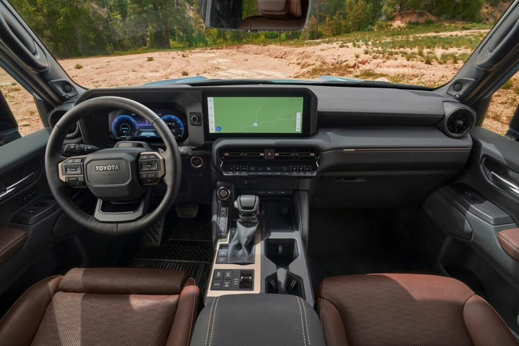

I thought the extra 4 speakers are the seperate JBL tweeters, two on the A pillar, 2 in the rear doors.
That could be, I havent seen a premium or FE in person. I only knew about the extra hatch speakers
You can see them in this picture, just above the vents.
