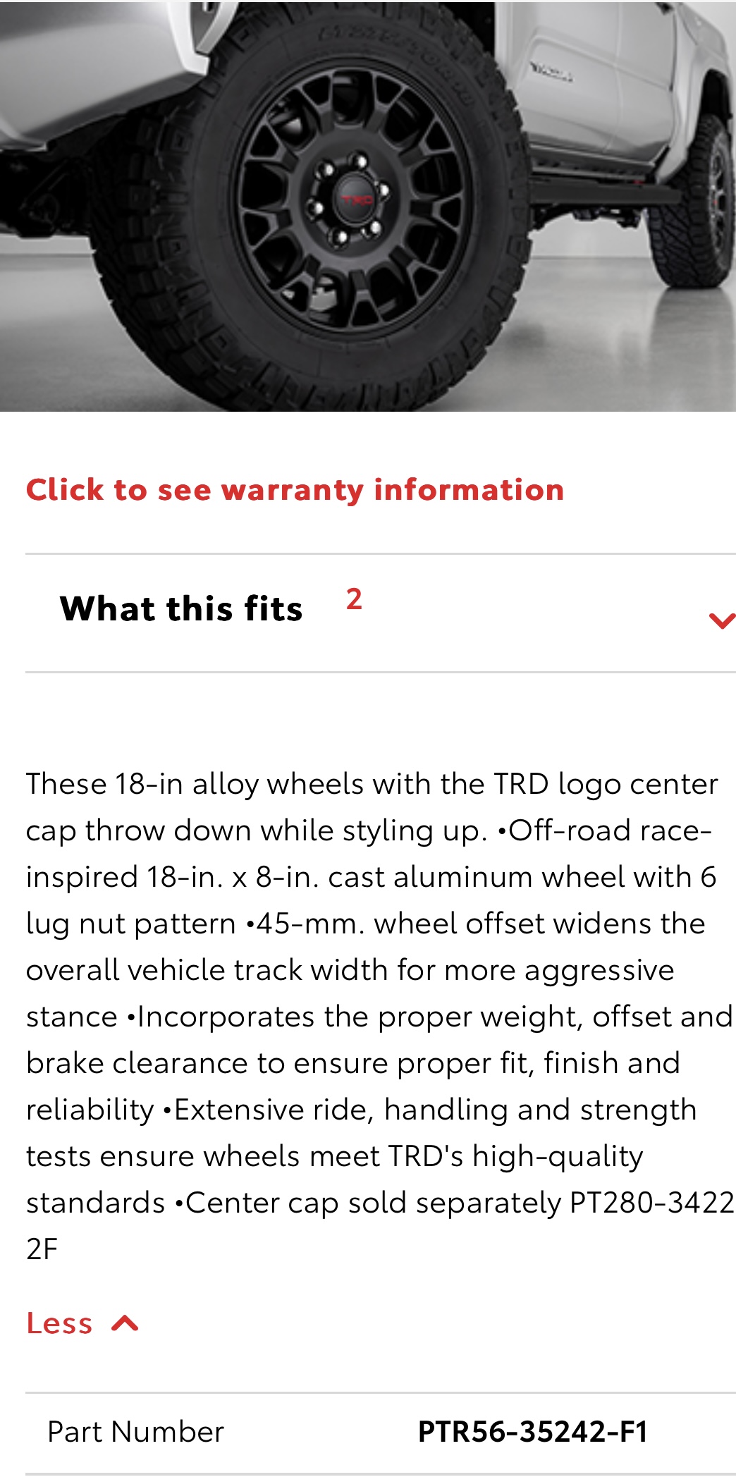

This is the tire and wheel combo I'll most likely be going with. Thanks for the no rub info.18x8 +45 with 285/70/18 Wildpeaks…no rub for me. No lift
Any chance you could post few photos on the front and side profiles please? I’m about to upgrade my tyres to 285/70/18 on this exact same TRD wheels and I have been looking for someone who has done the same.Don’t forget to order center caps or you can always reuse OEM’sView attachment 9744
