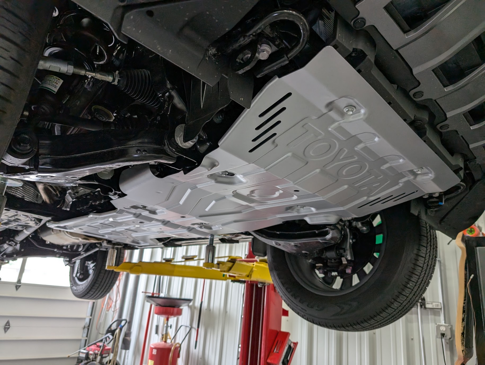

Hi there, I have the front plate already attached and looking to add the transmission and diff plates… does the transmission plate slide into the front plate to attach or does it have its own attachment holes? I can’t quite make it out from this picture. Thanks!
If I remember correctly, it slides under the rear of the front skid plate, so you’ll have to undo the front skid plate bolts to install the transmission plate.

Thank you so much for this, made job much easier. If only Hoover Toyota in Alabama imposters hadnt stripped bolts to OEM plates doing oil changes, this would have been a 30minute job. That's what i get for trusting others to touch my cars. Never again, warranty and disabilty be damned.
83, and have always done my own oil changes, etc. The part-time college kid at the lube station doesn't even know what a torque wrench is...
You may be able to save that hole by running a tap through it, I'd never even think about torquing it to spec again tho' but maybe enough to keep a bolt for ascetics. I'd also put just a dab of RTV at the bottom of the hole to keep an un-torqued bolt in place and still allow it to be easily removed for the next oil change.
If it were mine, I'd cut off the old thread pocket from the backside and weld on a new plate, then drill and tap to the correct size for a perm fix.
(edit) or install a nut zert if there is enough material for one to bite on.
I’ve used helicoils at work for repairing stripped out bolt holes that needed to hold >100lbs. If all else fails.
Thanks, I'll do this to repair it. I tapped them out but there wasnt much meat left.
I used helicoils on the last car nissan dealer stripped all the skid plate bolts on. Why cant dealers use something beside 3/4" impact gun to run in M8 bolts?
