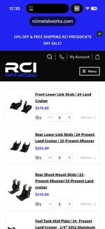

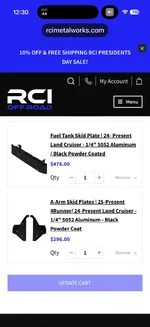

Hello! For context, I’ll be riding up to intermediate trails in very rocky terrain in Colorado as well as some riding in Moab. I have installed the “standard” skids from Toyota (upgraded front to back including rear differential). I know that I should definitely pick up a fuel tank skid but what about these others. I’m not running a lift, pure stock with 33’s. Do you recommend these additional skids for rocky terrain with an almost 100% stock rig?

In my opinion, the small skid plates intended to protect the lower shocks and control arms are ineffective. Because they bolt directly onto the components they are meant to protect, they provide no almost no load distribution or deflection before impact. The lower control arm (LCA) itself is already a very robust component, and since the skid plate is bolted directly to it, the force of an impact may still cause the component to fail.
Regarding the fuel tank skid plate, I recommend confirming with the manufacturer whether it is designed to support the full weight of the vehicle or at if it can articulate a figure. If it is not, an effective pressure on the tank skid could force the plate against the fuel tank, compromising its structural integrity. In that case, the skid plate would be ineffective, or maybe just better in load distribution. So with not a real improvement than the OEM lightweight skid plate.

Slee is fantastic for all things LC. I have some products from both Slee and RCI and generally find Slee to be the better of the two (I'm not saying RCI isn't good, just that I think Slee is better in my experience.) Here is a list of the skids on my LC which has seen a decent amount of time on trails in Colorado (up to trails rated "5" on OnX).
  • Upgraded OEM First Edition style skids (easy on and off for when I'm working on the LC)
  • Slee Rock Sliders (look fantastic and function well as a step)
  • Slee RCR (radiator skid - an absolute must)
  • Front and rear link arm skids (I recommend them due to the relatively thin sheet metal where they connect to the LC)
  • Rear shock mount skids (not required, but relatively inexpensive for the protection they provide)
I've taken hits on the rock sliders and the OEM skid plates, but have not noted any hits to the other skids. My A-arms did touch a few times, but I don't have skids for those (and don't plan to get them at this time.)
Agreed with the above posts. Fuel tank, absolutely, as well as the rad support. Shock mounts, diff skid, etc. is not really necessary or particularly effective.

This is another skid I’m thinking of installing. I’m pretty sure that I’m going to do this one as well as the fuel tank skid in addition to the lower link skids and shock skids. I’m thinking steel on the gas tank but it’s 60+ pounds in steel.

For Moab I'd definitely recommend a welded-on solution for the lower link arms on the rear axle where they attach to the frame and a good set of sliders.
Those lower link connections are prone to damage even on my 6" lifted 80 series with 35s with an identical wheelbase.
Agreed the lower shock mounts are next to useless, they may protect the bolt and lower shock itself but not much else and would make removal fun! May be a different story in a boulder field but at Moab the tire is going to lift with it unless you make a mistake a scrape along a rock, small chance if side slipping off a rock too but I wouldn't worry about those.
