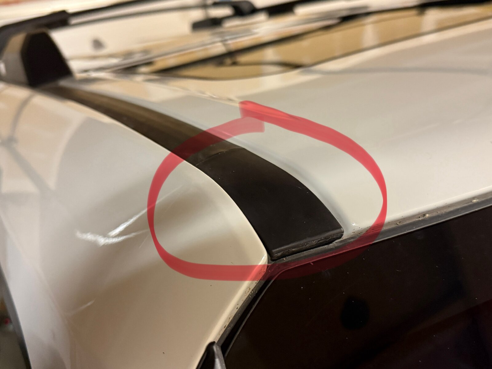

Lately I’ve been hearing a wind-related noise at highway speed - 75 MPH and above. It’s coming from the right side, maybe just above the windshield.
The trim that sits in the channel where the roof rails go has a head piece that runs right up to the windshield. That head piece is loose enough that at speed some wind could get underneath it and cause it to flap and flutter. My theory presently is that this is where the noise is coming from. Maybe for some reason the equivalent piece on the left (drivers) side isn’t quite as loose.
Anyone else experiencing this, and possibly developed a solution?

Thanks. Let me know how you do.
The trim piece you circled should not be loose. Verify that the clip isn't broken, as mine flew off the roof. Properly secured, I don't think this could make a noticeable amount of noise over the brick shaped mirrors and car body.
Not loose in the sense that it isn’t properly affixed with the connections that are present. Loose in the sense that there is enough space underneath the piece for 80 MPH air to get in there and cause trouble.
You would be surprised how much noise a little piece can make in that much wind if it’s given the opportunity to move.
The mirrors make a different kind of sound.
