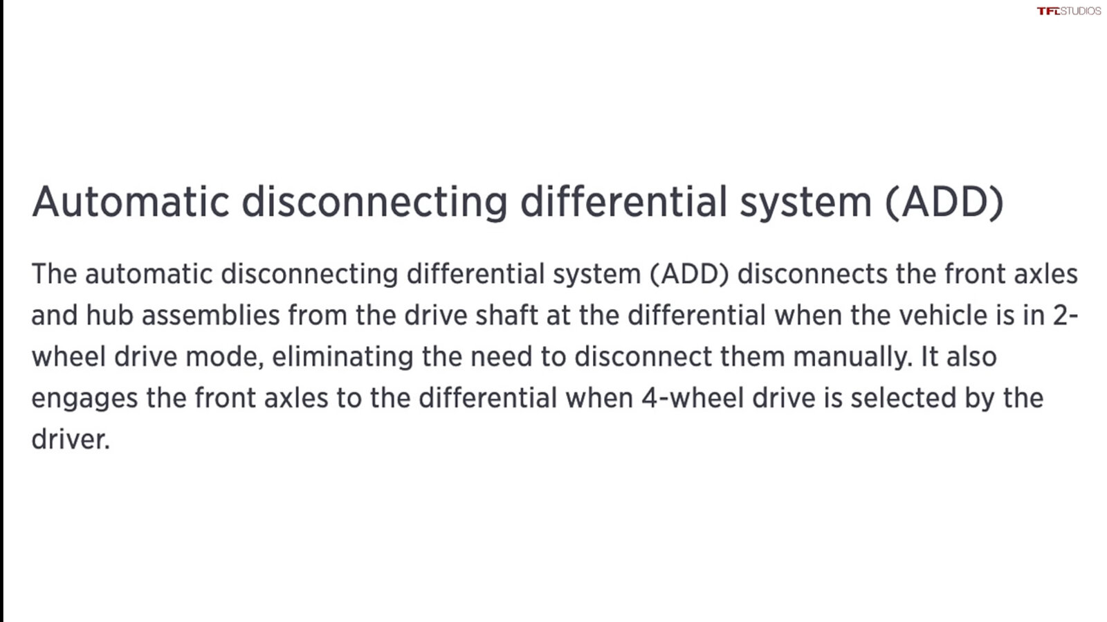

They took it up wheeling in icy conditions, got stuck, something popped and their 4 wheel truck became a two wheel truck. Given the time when it was filmed we are waiting for what failed (at the dealership). They did not abuse the truck.
Yeah i saw this. Eager to hear what went wrong. Definitely does not bode well for my confidence in any of toyotas newest models like the 4R, taco and LC.
I saw that episode. Looks like the front driveshaft snapped!!

Looks like a protection component (a part designed to fail to avoid catastrophic failure) in the front diff’s ADD worked too well. You’re welcome for the 11 minutes of your life back 😜
View attachment 1126Looks like a protection component (a part designed to fail to avoid catastrophic failure) in the front diff’s ADD worked too well. You’re welcome for the 11 minutes of your life back 😜
