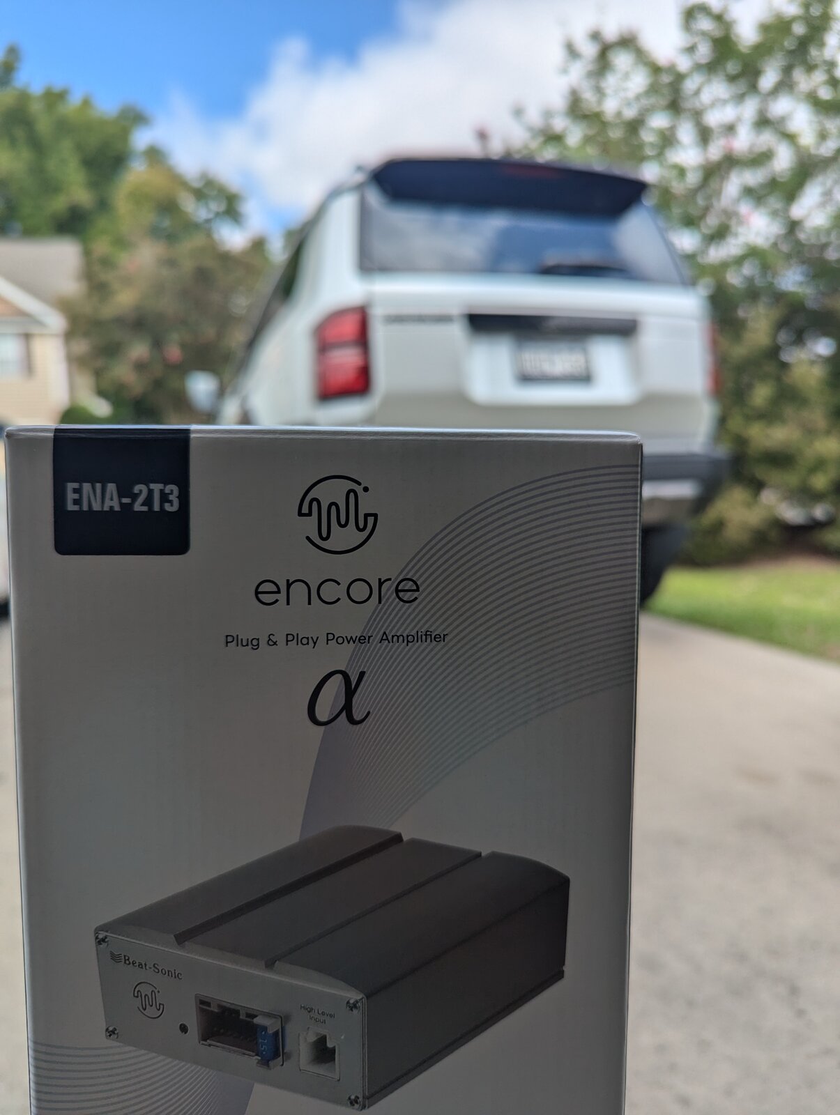

Installed the beat sonic amp in my JBL equipped cruiser today. Pretty shocked how much better the bass is now. Will it compete with a aftermarket sub? No. However, I feel it's worth the upgrade for anyone not wanted to install a aftermarket subwoofer. Install was smooth, and I just followed their YouTube video. Only oh crap moment was I powered up the LC (not start) while I had everything unplugged to test the gain on the amp. As soon as I started it, it gave a parking brake error. Got the gain where I wanted and turned the LC off. When I finished everything, and reconnected everything, the error remained and gave a visit dealer. I cycled the parking brake and powered off and on the LC and the error went away.

View attachment 8643Installed the beat sonic amp in my JBL equipped cruiser today. Pretty shocked how much better the bass is now. Will it compete with a aftermarket sub? No. However, I feel it's worth the upgrade for anyone not wanted to install a aftermarket subwoofer. Install was smooth, and I just followed their YouTube video. Only oh crap moment was I powered up the LC (not start) while I had everything unplugged to test the gain on the amp. As soon as I started it, it gave a parking brake error. Got the gain where I wanted and turned the LC off. When I finished everything, and reconnected everything, the error remained and gave a visit dealer. I cycled the parking brake and powered off and on the LC and the error went away.
Nice and yeah, I noticed a noticeable difference too when I had Beat-Sonic install the same amp for me a week and a half ago. I’m getting ready to build a subwoofer box with my buddy who’s doing the same for his brand new Tacoma and install an amp in the back for that in the next 1-2 mos. Oh snd I also had the same error after beatsonic installed the amp, but they knew exactly what to do before I even drove off their lot to make it go away, which is good because I would’ve never figured it out. The guys at Beat-Sonic are super chill and they only charged me $130 to install their amp and run cables (I provided the cables ) to the back so it’s ready to go when I do install the sub.
Did you run the nano off of the beatsonic output on the 3t3? Did you add a second amp or tap off the amp under the drivers seat?
