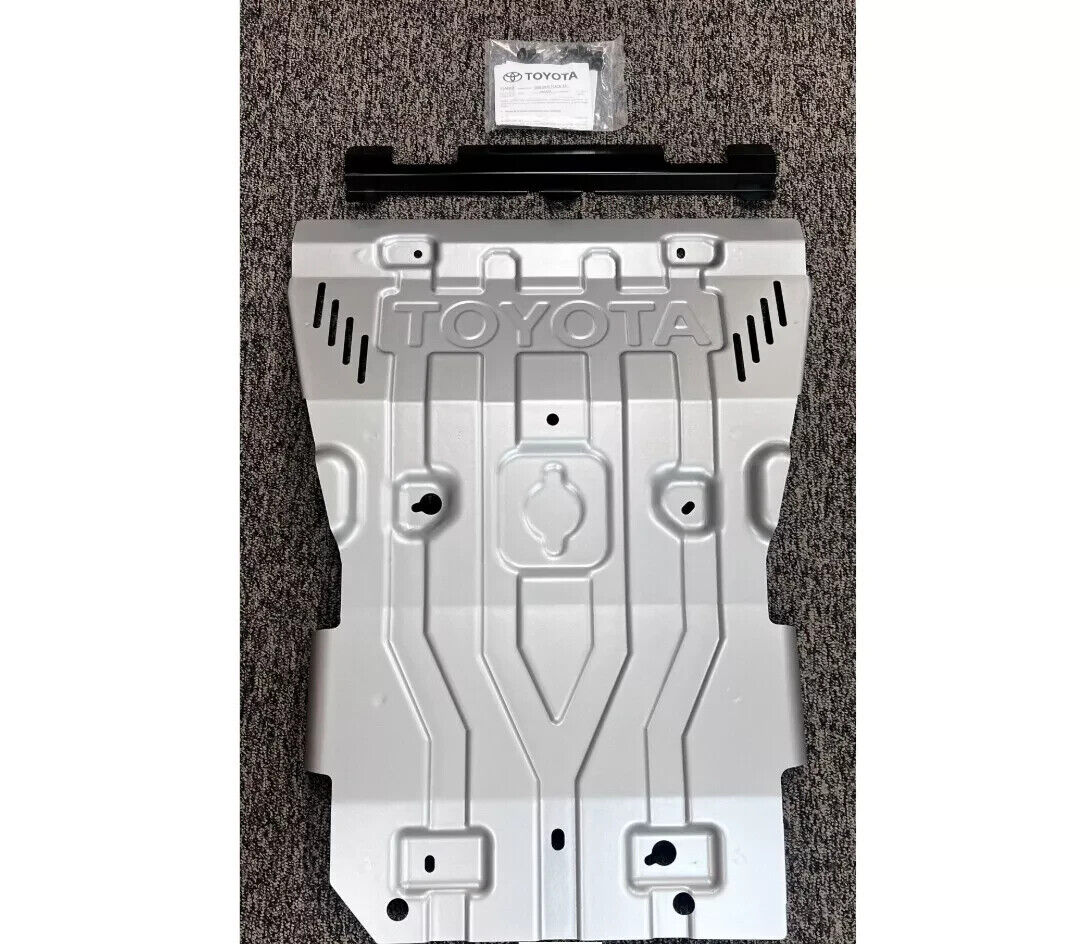

You should buy the OEM skid plates. The OEM plates are engineered and stamped to maximize strength and protection. Third party skid plates are made by two guys with a CNC machine. They can't stamp sheet metal, and the have not done the engineering to optimize protection.
If you need steel skid plates you probably purchased the wrong vehicle.
This is what a skid plate made by automotive engineers looks like:
