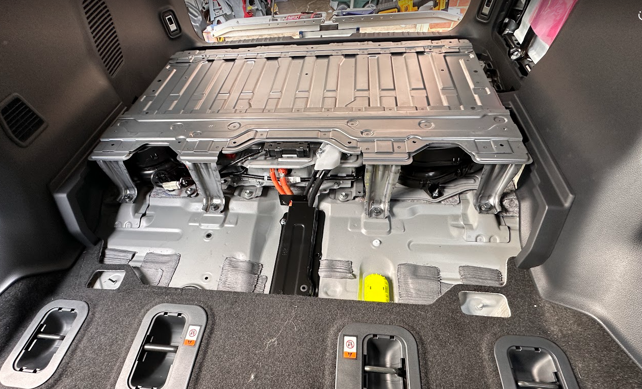

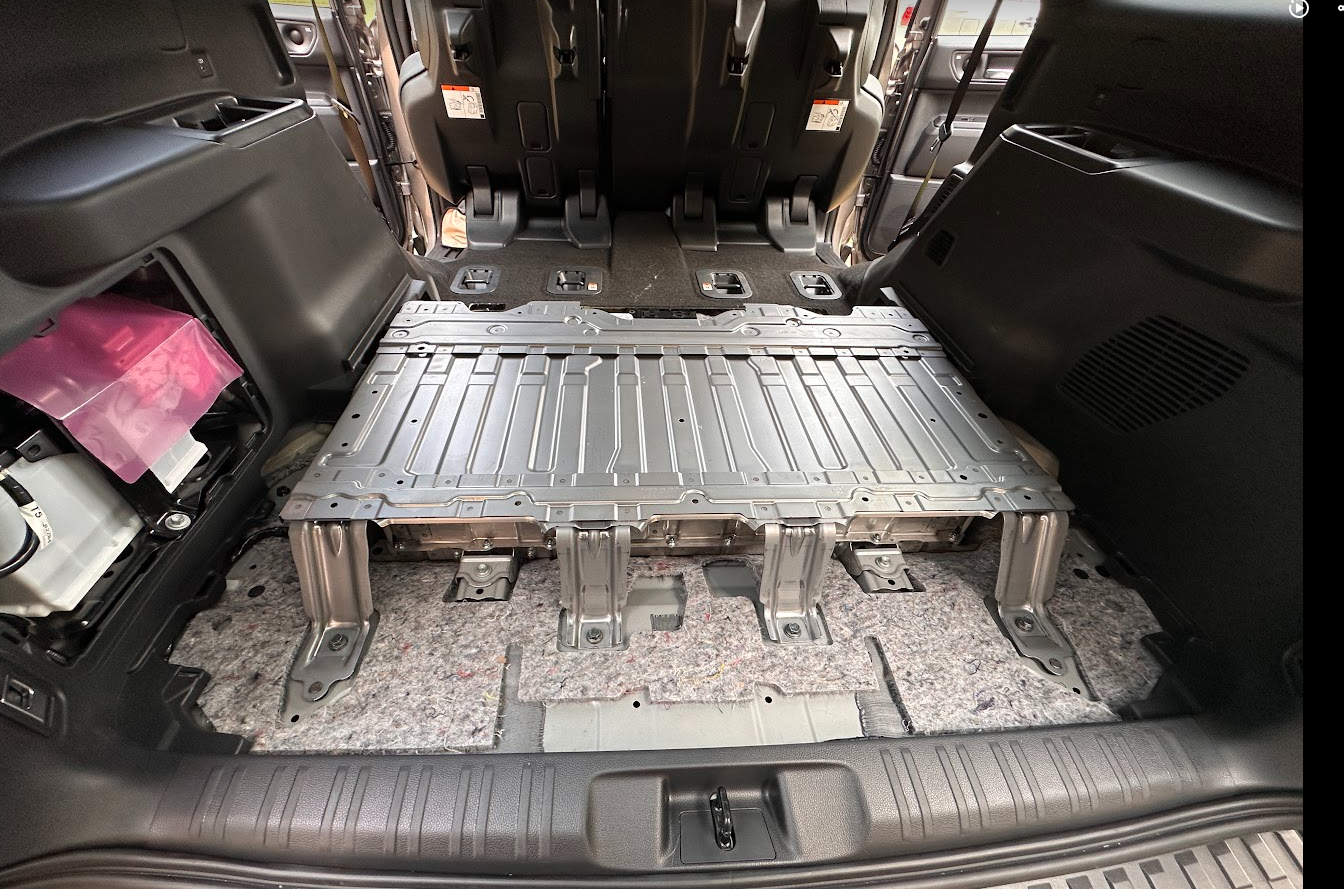

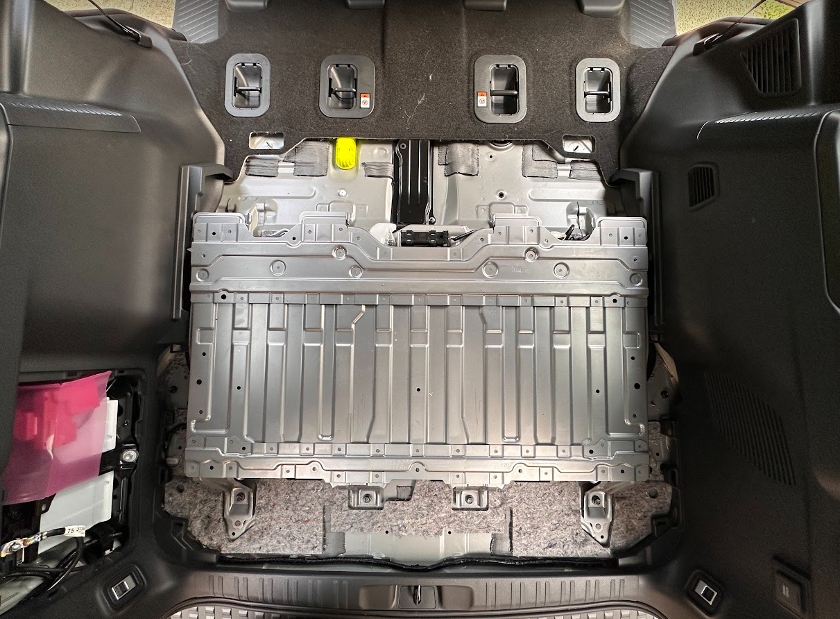

In my quest to build the cargo platform, I took all the "floor" trim pieces out. Below are a few images of what the cargo area and battery.
Would be nice it Toyota could find somewhere else to put the battery, but on the other hand it's nice to have everything safely inside the cabin. And I do like my storage compartments!

looks like it is a more or less straight forward task to have the battery swapped out in 8-10 years from now for the ones who want the LC to run for 15 or more years. I don't understand why they didn't move the battery all the way towards the rear seat and make the easy to access cargo cubby at the rear hatch twice as large. The cubby right behind the rear seats is not as easy to access. I guess it might have to do with mounting points for the the third row that would be there.

Thank you for sharing. Where in these pictures is the car battery? Is it showing and I am missing it?
It's behind the pink translucent plastic you see in the pictures. That is attached and loosely draped over the positive terminal of the battery.

@EOD Guy is correct. I was looking for mounting points. Additionally, I replaced the OEM cover over the battery with 1/2" plywood for a temporary platform. I have a trip coming up in September and I needed something to attach my frdige slide to as well as strap cargo to.
Here's a picture of the finished temporary product.
I used the two holes that were prexisting from the original cargo tiedowns (M6 Bolt) and then drilled and attached 2 rivnuts in the metal plate covering the battery. That top plate is about 3/4" above another metal plate that incases the battery components themselves. Additionally, the cooling vents for the battery are on the fronts of the wheel humps near the back doors.
