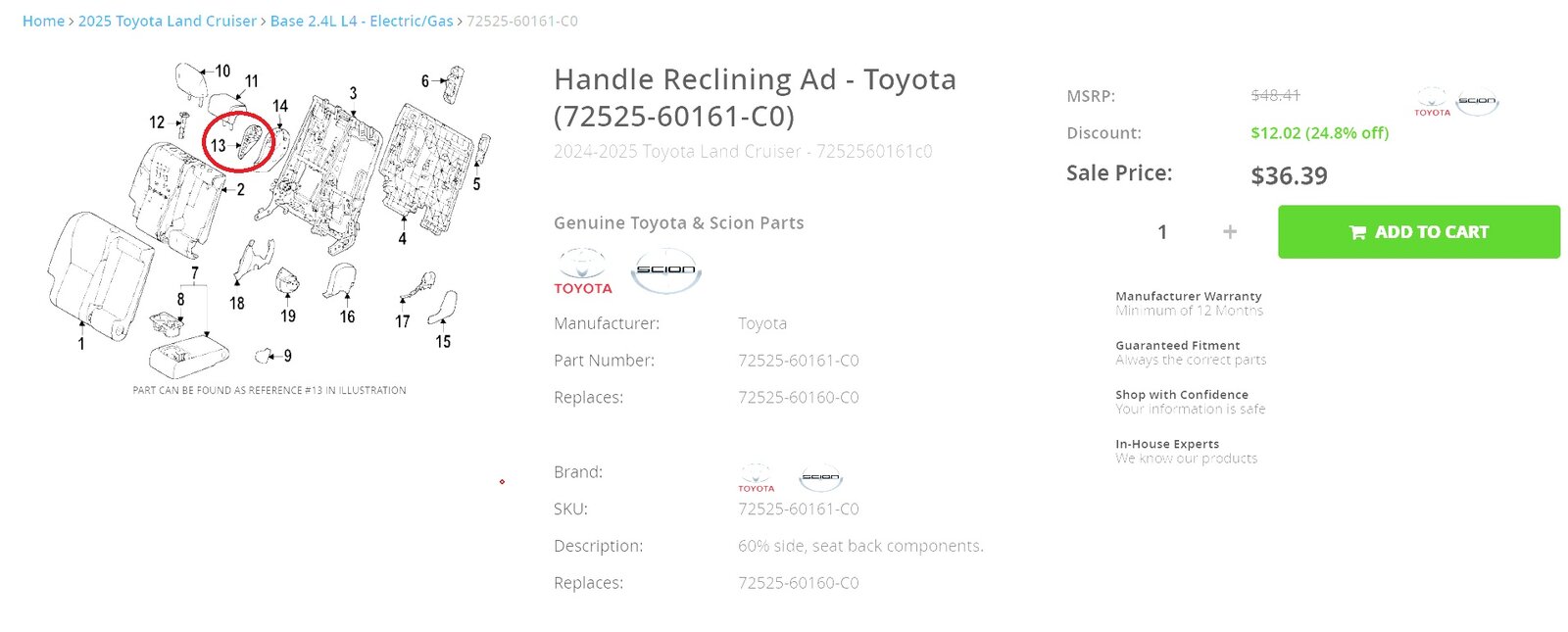

Hey there - brand new here. Admittedly know very little about automobiles in general, but love the reliability and value of Toyota.
My question: Currently have a 2024 Land Cruiser 1958. I broke the recline lever on the side of my back passenger seat and wondering if someone could help with guidance in ordering a replacement part. So far I’ve browsed the internet, but it’s very hard for me to tell exactly which lever I need. Feel like it could be the lever with Part Number: 7252526160C0 - but again, I’m unsure.
Thanks. I do appreciate any input and assistance.
I think this is it.

Welcome to the Jungle!
This may help you with the repair.
  • REAR NO. 1 SEAT ASSEMBLY (for 60-40 Split Seat Type LH Side) Disassembly.pdf
  • REAR NO. 1 SEAT ASSEMBLY (for 60-40 Split Seat Type RH Side)- DISASSEMBLY.pdf
  • REAR SEAT REMINDER SYSTEM- PARTS LOCATION.pdf
