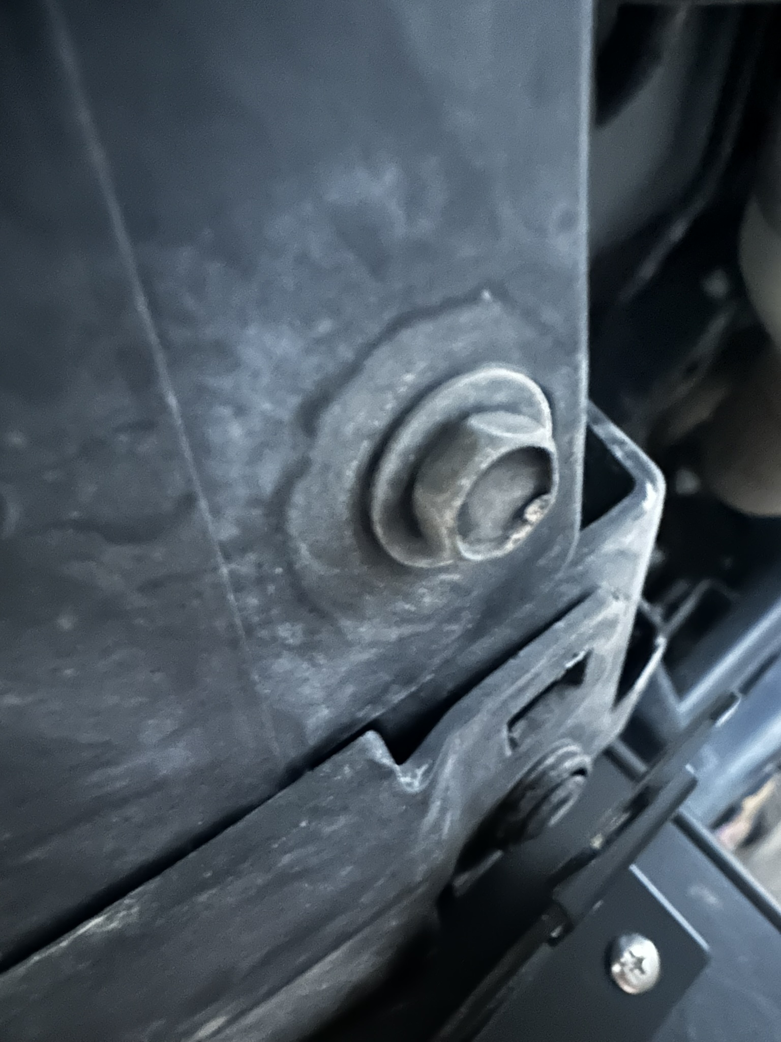

What's everybody using to attach the lower bracket with the strap on the rear? The front mudguard has bolts in that location, but the rear does not. I tried one of the trim clips and it doesn't work.
The rear one also has a retaining screw, check it carefully, it is the screw that held the plastic fender together with the rear molding. At least in my car, Regards
Strange. I've just got a square hole where the bracket lines up.
That's because the metal clip where the screw threads has fallen off. Check to see if you can see it, otherwise you'll have to get a new one. Regards.
Yep, didn't have the metal clip on either side. I'll have to go grab a pair.

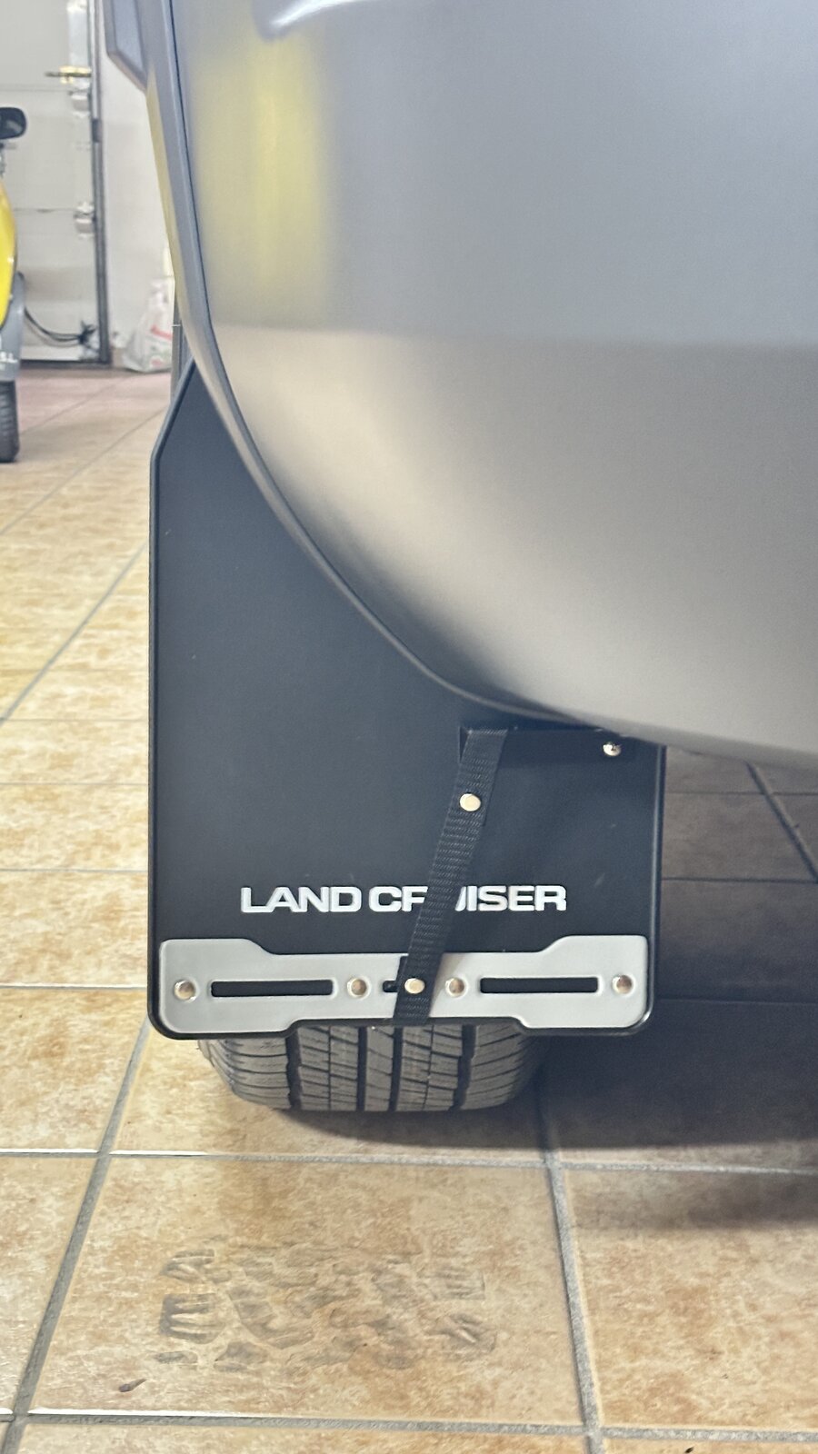

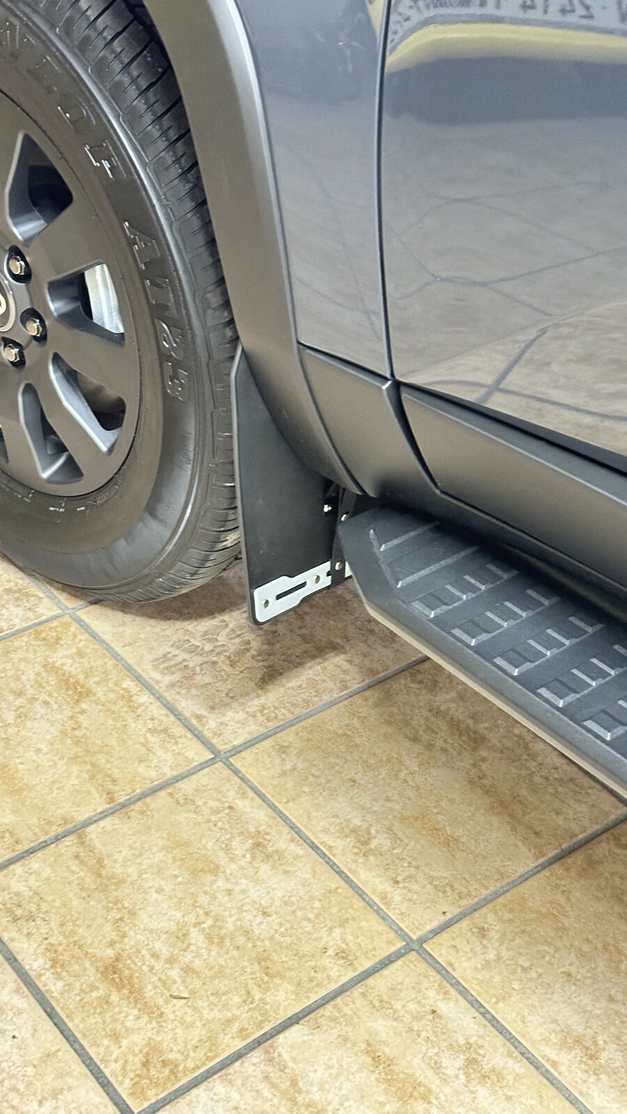

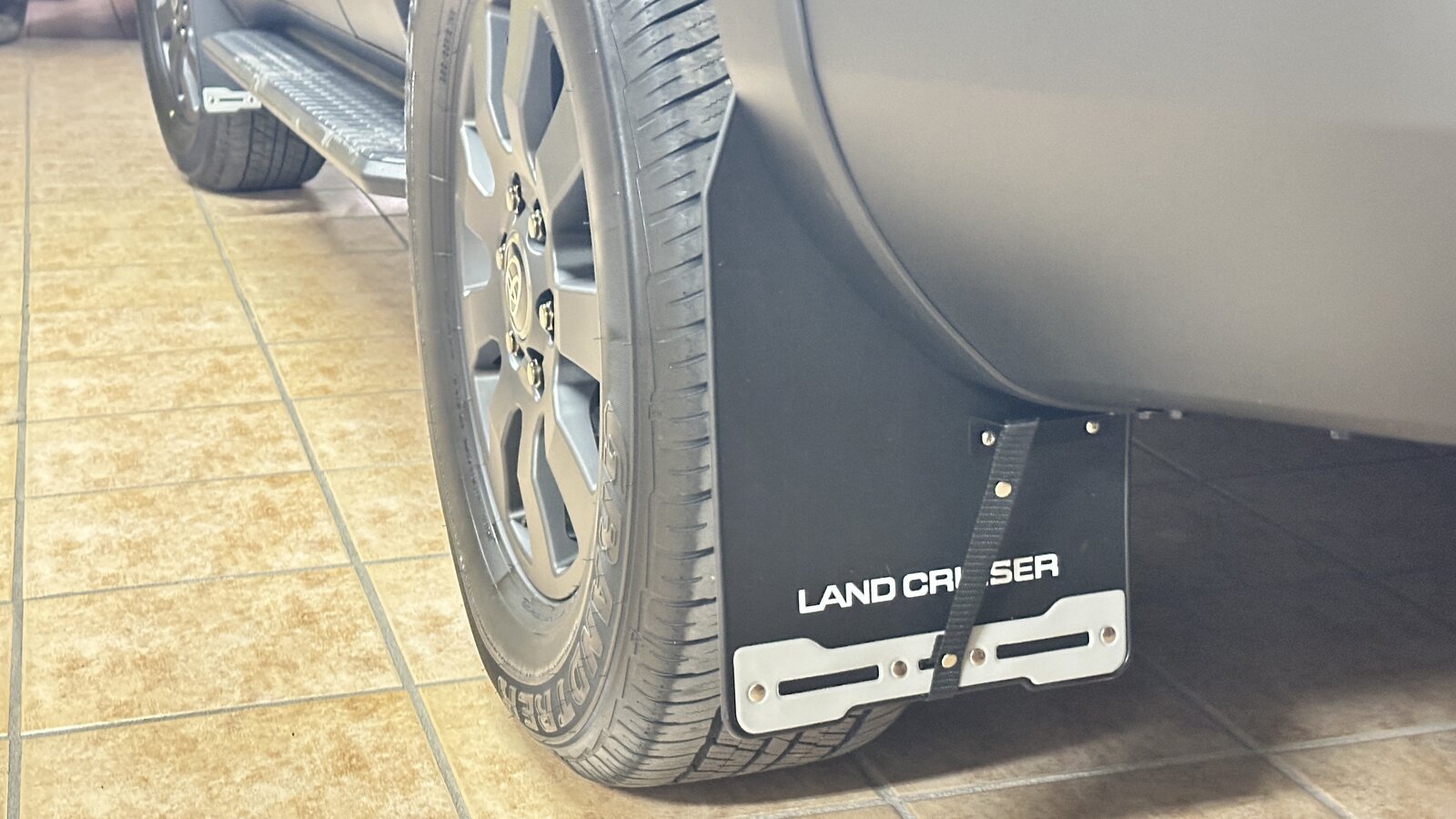

Just installed the mudguard from cartrimhome.com. The product is ok for the price. I was expecting them to be bigger/wider than the originals, but they are about the same (see picture).
There was some trimming to do on the front ones, but it was fairly easy if you take your time and do a template. First one took 30 minutes, second one 5 minutes. I used a pair of sheet metal snips/cutter.

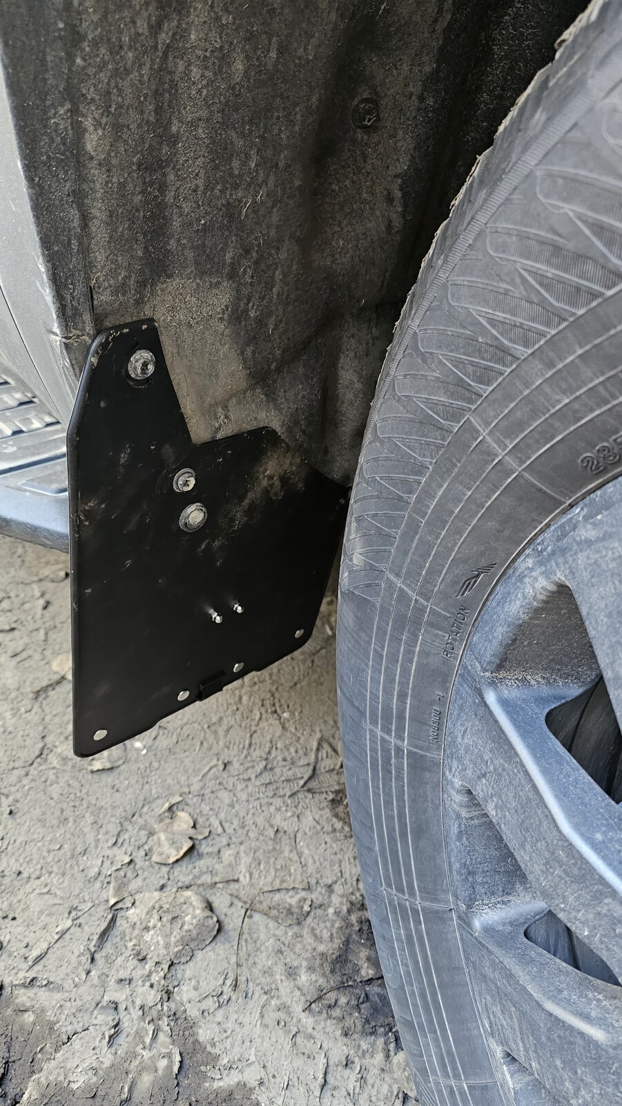

Mine fit without any trimming... View attachment 33095
Wow. I could not installed them without any trimming. The inside part would not stay flat, and I was afraid of getting some rubbing while backing up with the wheels turned.
I see you are in Europe. Maybe the inside of the wheel arch is different in your market.
Idk. I have a SDM. If you don't, maybe there's some difference...
The reason is in the photos you have posted, for some reason I don't know, the wheel arch protections of American vehicles A and the rest of them B are different, and that makes them not fit.
