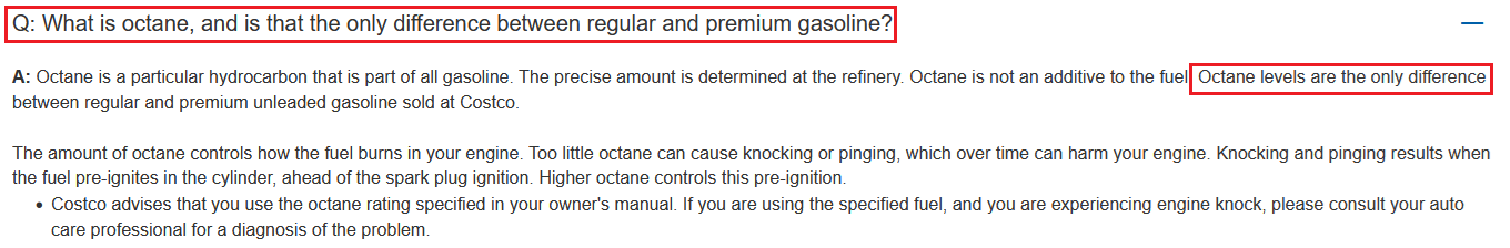

From Costco Gasoline's FAQ, and I imagine everyone else does it this way, since Costco does not manufacture gasoline. Aka this thread is a discussion on octane.

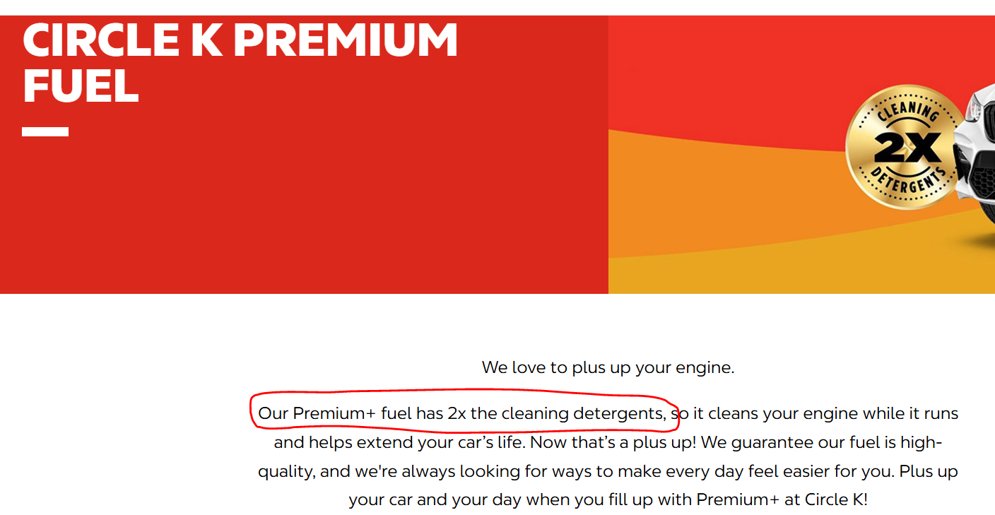

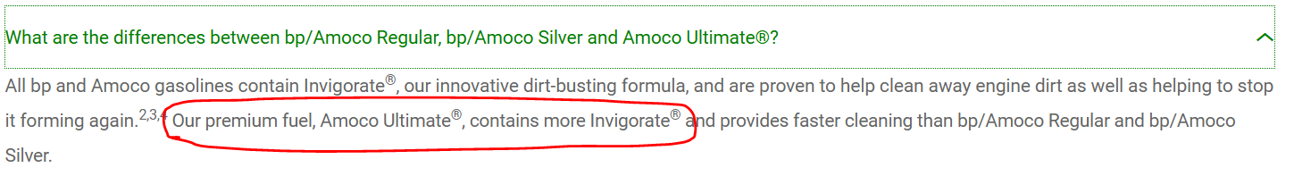

This may be the case of Costco, but many other brands use different amount of additives depending on the grade.
Circle K
BP / Amoco
Circle K
BP / Amoco
Sure, but the fact that they specifically call out that their premium fuel contains more additives inherently implies that isn't part of the definition of premium fuel.

And because most gasoline retailers don't indicate clearly on their pumps if their Premium gas has more additives than Regular (Circle K and Shell do, BP/Amoco and Exxon don't, for example), the only sure way to know that you are getting a full additive package is by using Premium. Or cross your fingers, refuel with Regular and hope that they are like Costco (most are not). I prefer to rely on facts than hopes.

Circle K
BP / Amoco
Circle K may say they have twice the additives, but they still don’t qualify to be a top-tier gasoline. If you look in the land cruiser manual not only do they specify a minimum required octane, but they recommend utilizing a top-tier gas. Circle K used to be Shell gasoline, and it was a top-tier gasoline, but then they switched to their own brand and they are no longer top-tier. Costco and Amoco are, it is listed on the top-tier website and on their pumps.
