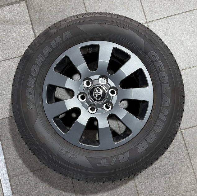

The factory wheels are the same as (2022-2025 TOYOTA TUNDRA FACTORY OEM 18" CHARCOAL ALLOY WHEELS RIMS 95952) which came with Yokohama Geolandar A/T G31 size 265/65R18.

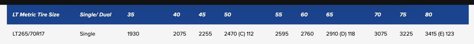

Long story short - LT tires are inflated to the same pressure whether they are C, D, or E load. The difference between the tires is the maximum inflation pressure, which increases from C to D to E, with E having the highest possible inflation pressure because they can support the greatest load.
For a load of 2100 lbs (which is equivalent to the OEM SL load tires), you'd be at 40-41 psi. If you want the details of how I arrived at 2100 lbs, then go to my prior post. The load tables are based on the ETRTO tables and should be the same pretty much anywhere in the world. If in doubt, do a chalk test as suggested by @RideWithYanu .

Firstly i appreciate the time you have taken writing this.
As for the PSI, you seem right with 40-45, visually appealing from the tire pattern, and not 33 as the tire dealer informed me (i know they do not understand the psi changes with the tire, had my experience with my previous vehicle).
The chalk test seems the best and easiest solution, will try doing that.

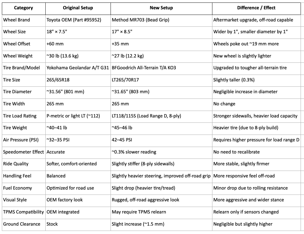

WIthin my best findings, and some deep searches with chatgpt, I have attached a table of the summary between my before and after changes. I have also attached a picture of the stock wheels, for your reference as i believe you should be having the same ones in the UAE.
As for the speedometer, since i have purchased the vehicle, at 136km/h on the speedometer, the gps on multiple devices was showing that i am at around 128km/h. And at 80km/h, the gps was showing about 75km/h. So it's off by 5-8 km/h. After the tire and wheels changing, the speedometer still off by the same numbers, no changes up or down.
By these info, i should not require any re-gear tuning, correct?
Appreciate your assistance on this.

Correct. I say this with good will: you’re overthinking this! You don’t need a retune or regear with such a minor change.

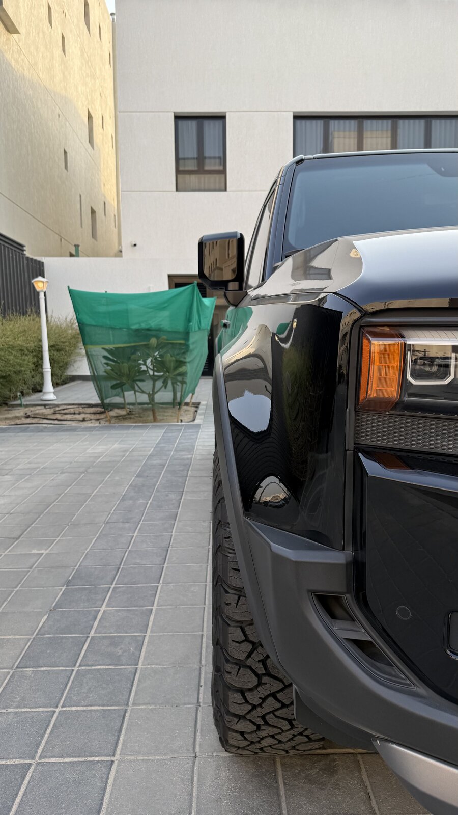

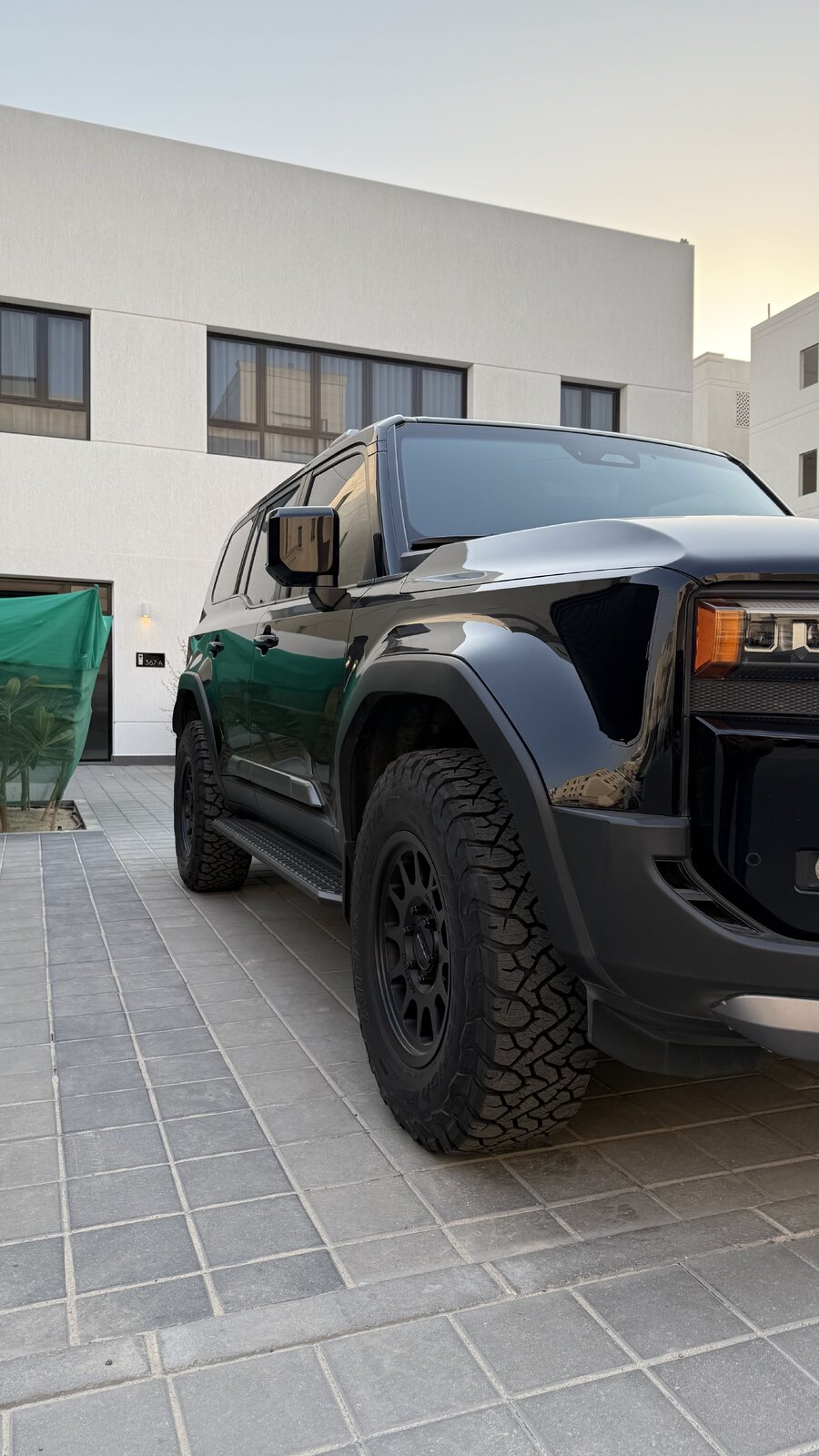

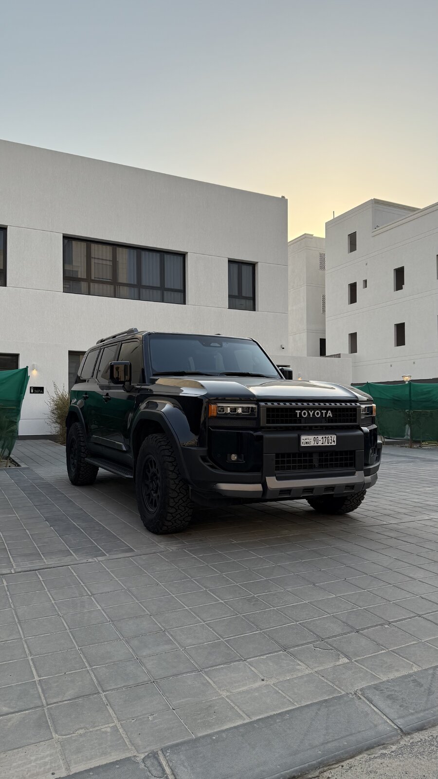

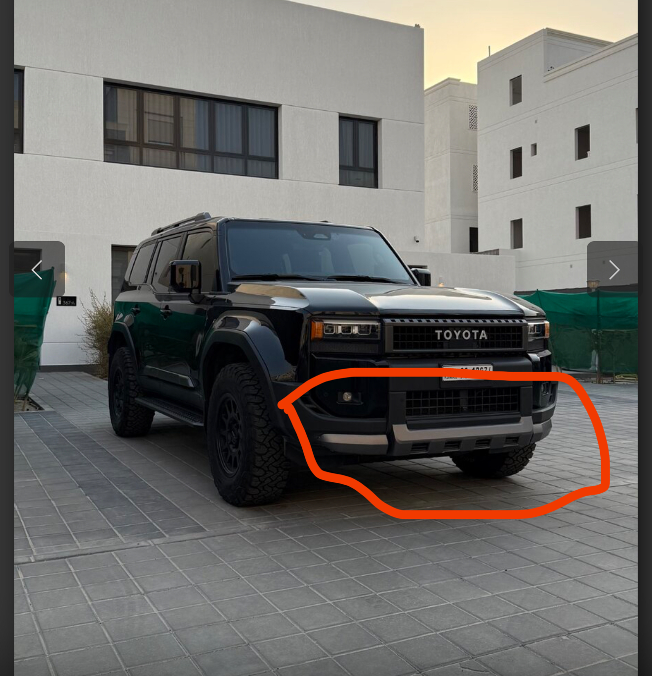

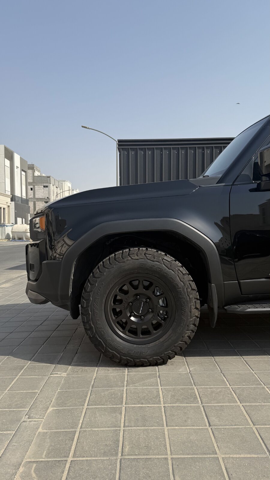

Sharing some images for the ones wondering how it looks!

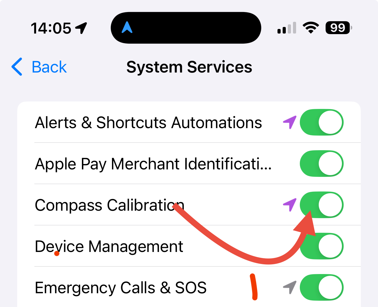

You mentioned GPS devices being compared. May I know which one. Are these Portable ones . Then you may recalibrate those devices for better accuracy
For iOS - Goto
Setting-Privacy& Security-Location Service is toggled ON. Tap System System Services, Make sure Compass Calibration is ON. Tap back. Enabke Precise Location - Always ON. And Toggle Background Refresh. To align. This should work accurately. On Garmin Device, ideally do this outside in an open area. Aways from Cell Towers. . Google it how to and you should align both accurately.
For iOS - Goto
Setting-Privacy& Security-Location Service is toggled ON. Tap System System Services, Make sure Compass Calibration is ON. Tap back. Enabke Precise Location - Always ON. And Toggle Background Refresh. To align. This should work accurately. On Garmin Device, ideally do this outside in an open area. Aways from Cell Towers. . Google it how to and you should align both accurately. View attachment 44533
All what you have stated is turned ON in my iPhone. I have tested the speed in iphone, android with different websites/Apps, and my garmin dashcam. They are all giving the same numbers, thus, i believe it's accurate.
