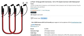

There would be nothing wrong with using Anderson connectors. As far as attaching a lead from the 12v battery again perfectly ok. You might think about using the "under-hood" jump point vs directly to the 12v battery.
I currently have my ViAir connected to the under-hood jumper point with no ill affects.
You may also consider using some heavy duty 12v connectors vs the Andersons. The reason I suggest this is the 10awg should carry the load just fine and it opens up a host of other possibilities that don't necessarily need 10awg wire. For example a trickle charger, work lights or solar chargers. The best part is the size of the connector vs the size and cost of the Anderson. The Anderson does have a neater wire attachment vs the pig tail that would have to be cut and spliced etc. But if you use shrink wrap and use "woven loom" to cover the entire length of the wire, it results in a factory type/look install.
