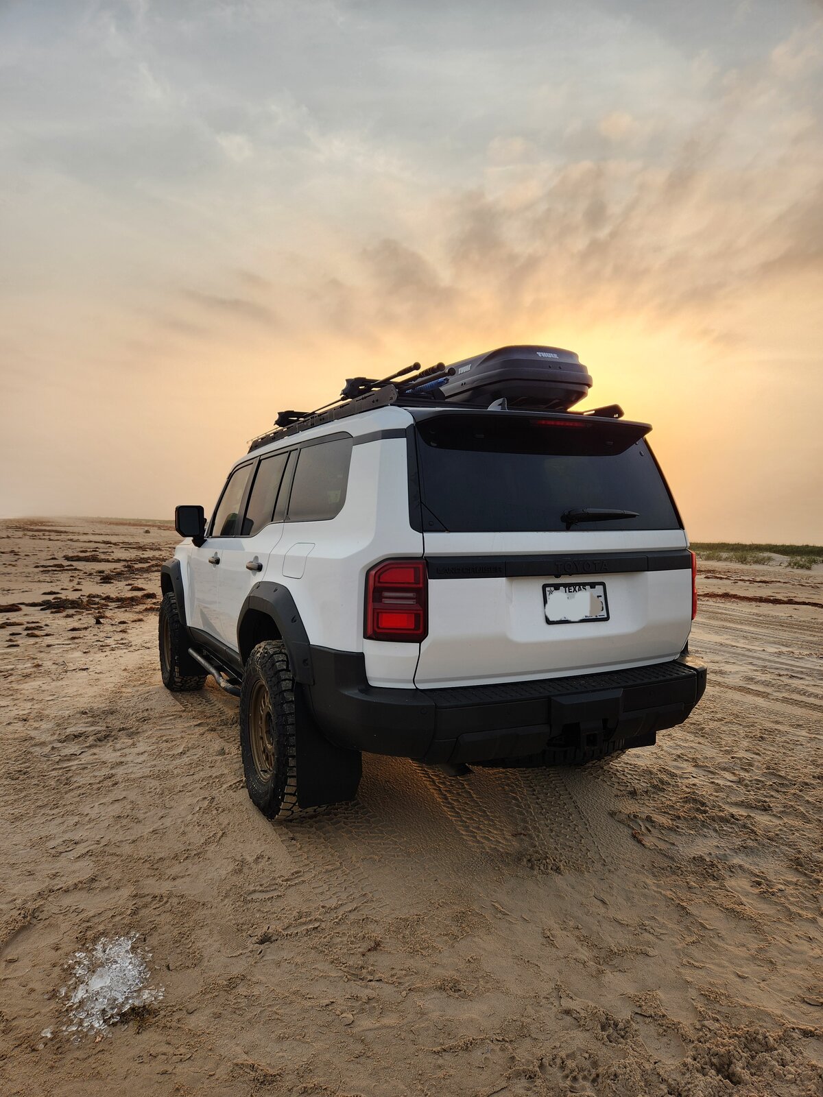

I took my canoe for a 1000 km spin last weekend. No issues with security with front and rear straps and a rope with a truckers hitch over the middle.
p.s. Used my old thule square crossbars.
Rhino Rack J-hooks on Rhino Rack Vortex aero cross bars.

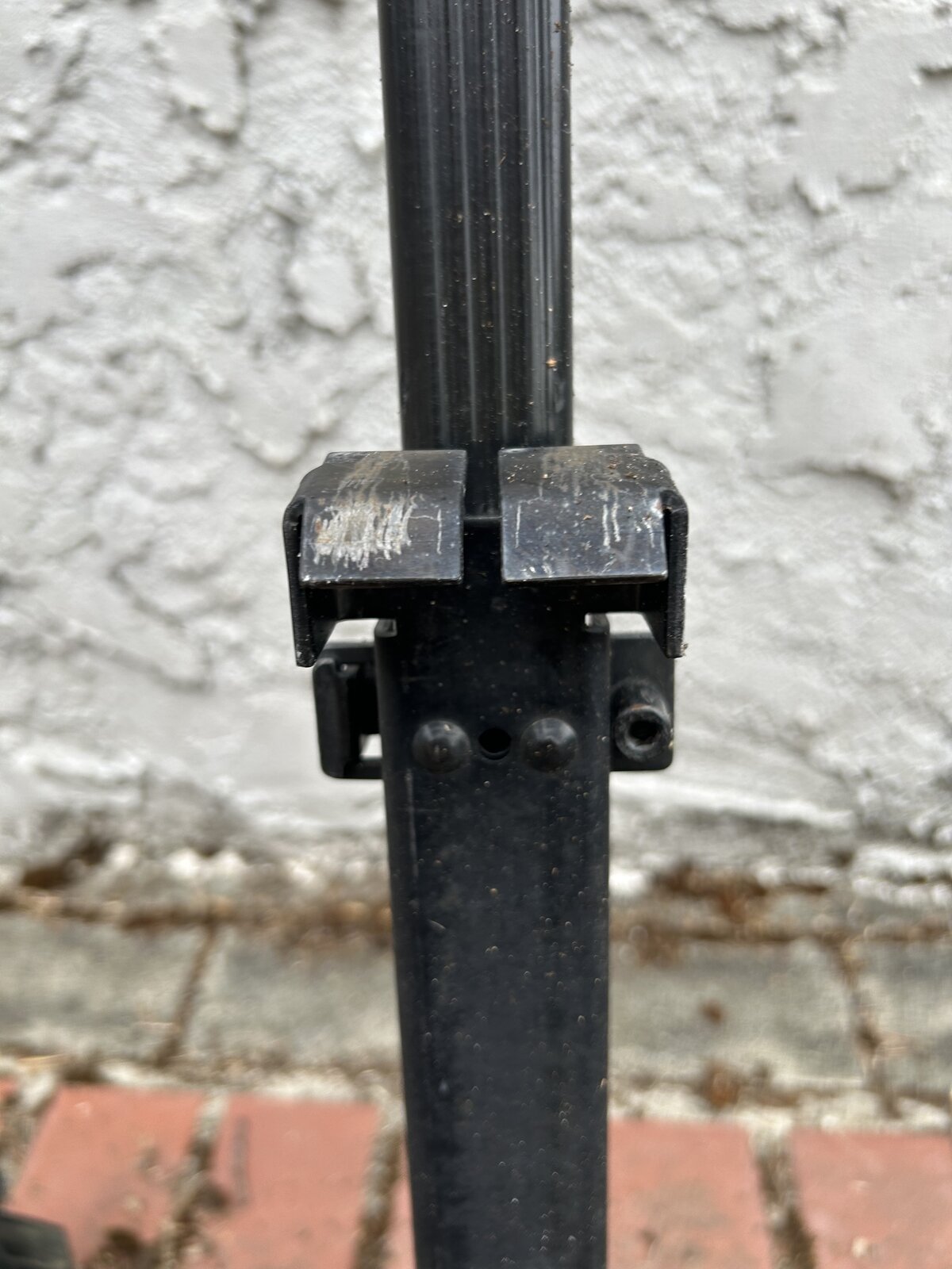

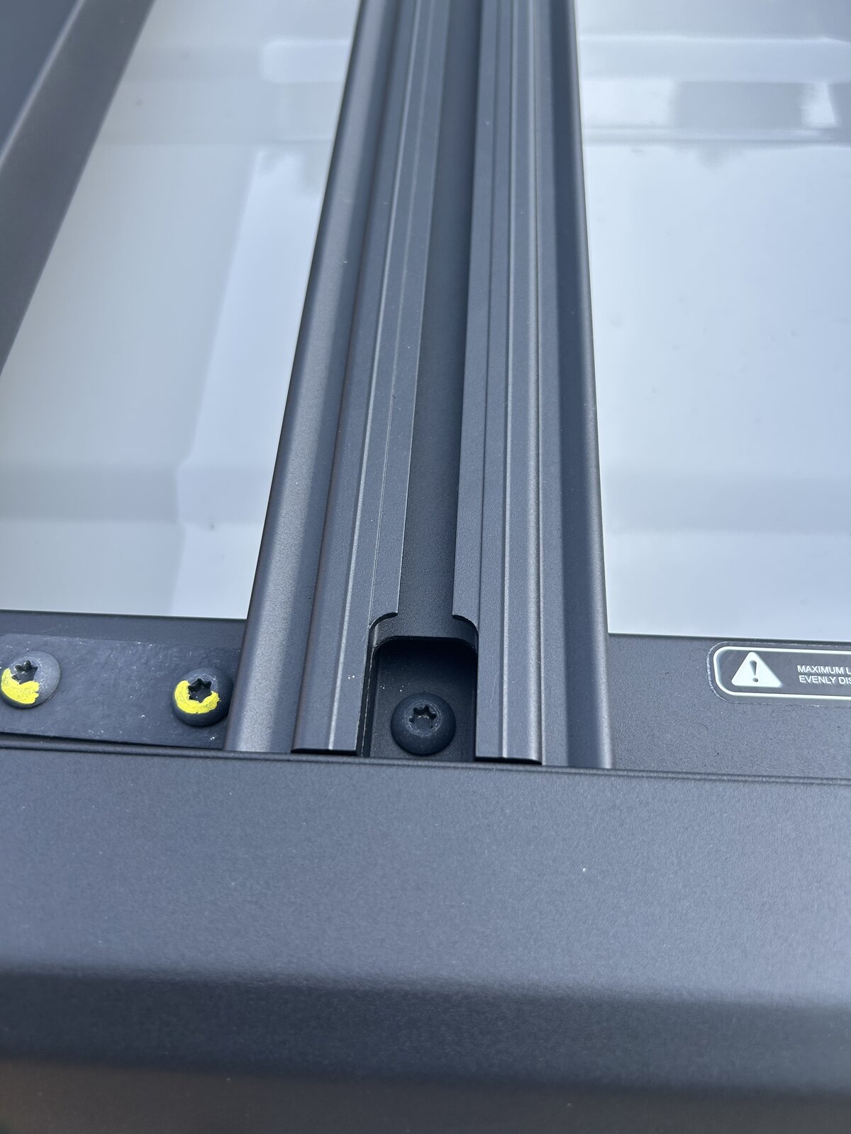

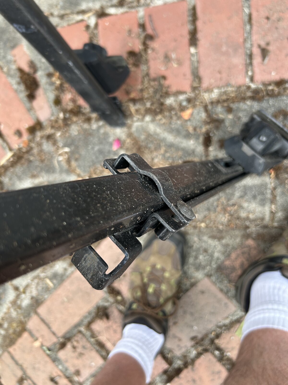

I'm working on trying to get my hullavator rack system onto my LC Standard Toyota Accessory roof rack but it doesn't look easy. The Thule configurator website didn't provide any options so I'm guessing it's not supported. I'm going to try and get it done on my own. I'm bringing the hullavator over from my old 4runner which had the Thule feet and cross bars. Here are pics of the standard roof rack rail I have which basically just provides a slot for bolts. Also are some pics of my tower and the mount for the hullavator coming over from my old 4runner. Any thoughts or help is greatly appreciated!

I'm working on trying to get my hullavator rack system onto my LC Standard Toyota Accessory roof rack but it doesn't look easy. The Thule configurator website didn't provide any options so I'm guessing it's not supported. I'm going to try and get it done on my own. I'm bringing the hullavator over from my old 4runner which had the Thule feet and cross bars. Here are pics of the standard roof rack rail I have which basically just provides a slot for bolts. Also are some pics of my tower and the mount for the hullavator coming over from my old 4runner. Any thoughts or help is greatly appreciated! View attachment 40720
I can not envision what you are trying to do from your pictures........ I assume you are trying to mount that rail onto the LC's roof crossbars. I'm not sure what the hullavator feet/mounts look like, but if you were to purchase some "T" bolts from Amazon, the "T" would secure in the LC's bolt track/slot. You could then purchase a piece of alum round stock and make some spacers/stand-offs.

I was able to finally get my Thule hullavator installed on my LC today! I used four stainless steel T slot bolts (M8 x 65MM) as recommended above (thanks all for your advice!) with stainless steel washers, and lock washers. I basically used a 3/8" Kobalt steel drill bit to drill four holes through my existing Thule crossbars from my old 4Runner installation. Then just slotted the T bolts into my LC cargo rack and tightened them down. Once mounted on my cargo rack the rest of the hullavator install was as per the hullavator installation manual. I'll try to capture a video of the pistons lifting the kayak up on top. It is super easy and takes about 10 seconds. I think this is the safest way to mount a kayak and would definitely recommend a hullavator to keep from hurting yourself and your LC!
