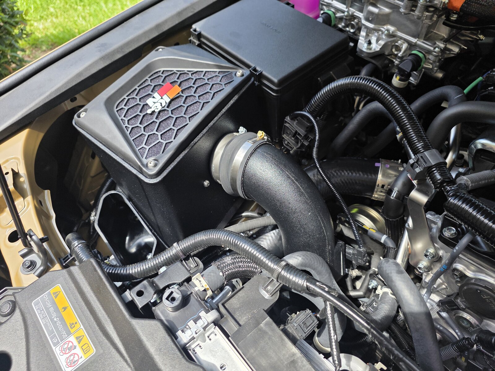

installed the K&N System yesterday(PN: 63-9043), i did NOT disconnect battery per instructions. Afterwards i drove it 3 miles to get fuel and was thoroughly enjoying the new sounds, subtly like the Trailhunter snorkel, but much less obnoxious. It is really cool hearing the turbo spool up🏎️

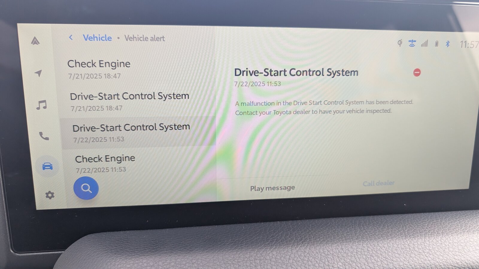

1/2 way home after filling up, the dash lit up with check engine lights and Drive Start control error.
drove fine and no noticeable loss of power or limp mode observed.
once home did some Googling, and then disconnected the battery negative terminal for a bit, and then reconnected and started up int he driveway only, CEL's gone. i did not drive it again.
i will be driving it to work today and fingers crossed it's fine.
thoughts are that the ECU is seeing drastically different airflow, so it triggers this sequence of CELs, or i somehow installed the MAF sensor wrong, but 99.9% confident it's fine and in the correct orientation, 0.1% could be from topping off gas tank?

Update: 30 minute drive to work, no issues this morning.
Go to lunch, and about 5 minutes into the drive, all the same CELs popped up. No impact to drivability that I can tell.
Very frustrated and probably reverting back to stock, not worth the trouble TBH.
the one thing in common is that the CELs came on on the 2nd startup each time.... not sure if that's significant
i decided i didn't want to keep driving like that in hopes that maybe 5-6 startups later it just resolves itself, so i am back to stock now

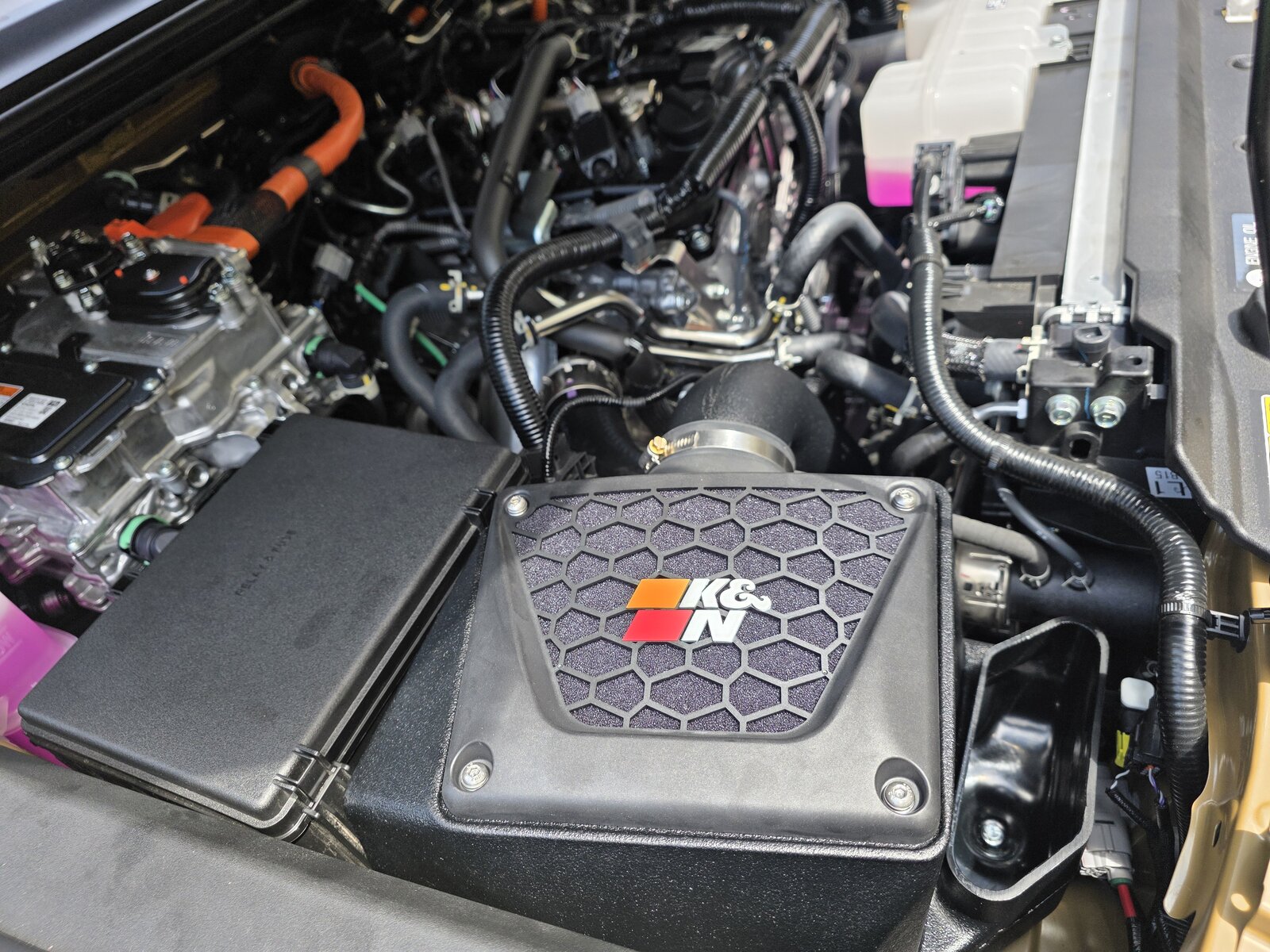

Double check the roto molded tube. My first one had an odd cut out “egg shape” that didn’t let the vacuum hose seat right. Causing a big air leak. K&N sent one within a few days and no issues after it was replaced. Also make sure you have the block off plate on the front. It could be effecting your air/fuel ratio with the extra opening. There kit does eliminate the intake resonator. Over it’s a great intake system. I’ve had mine for awhile now and no issues after the tube was replaced.
Only issues I had with this PN on a gas 4Runner was when I tried to use an AFE Scorcher.
77 Series on this vehicle has not thrown any codes. Unlike the 63, it does not require removal of the plastic intake manifold.
Installed with negative disconnected, and without the front duct cover (was not in packaging). Drove 6mi. no codes or alerts.
Will call K&N to get a discount for my missing piece... haha. See if it's even necessary in our LC's.

congrats! happy you are having better luck than I. one thought about the lack of the cover plate is that you are drawing in hot air from the engine bay as well as colder air through the fender... i think the block off plate is needed.
