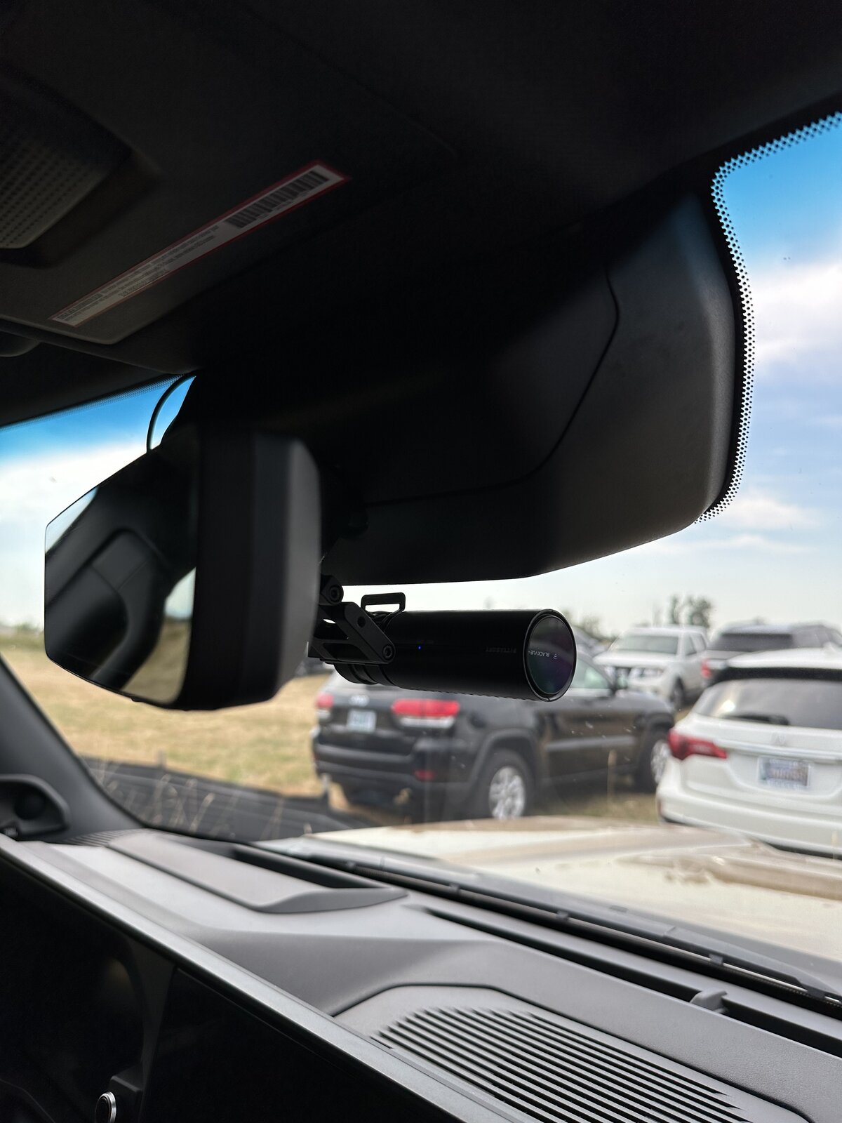

I’ve got a BlackVue as well and used the blend mount. It disappears behind the rear mirror from the driver seat and I don’t really see it.

Wanting to get away from mounting tape as my sole support for my dashcam as currently it seems to un-adhere from the windshield after a day in the sun, alternatively, find another solution (see loctite mention below).
Are there any hardware solutions for mounting existing dashcams for near the top of the passenger windshield area?
Setup:
  • LC parked in direct sunlight frequently in Southern California, sometimes Arizona
  • BlackVue DR970X-2CH LTE Plus dashcam, weighing 2.15lbs.
  • Windshield Tint: Ceramic tint on the windshield (XPel XR Plus Ceramic Series) -- cause of my issue? Non-optimal adhesion?
  • Gorilla Heavy Duty Double Sided Mounting Tape ("in-use temp. up to 248F"
    • Considered using LOCTITE 402 Ultra Performance between the tape and the windshield, but fear this could screw up the tint, void its warranty, then fall off anyway (open to feedback here)

I ran an older version of this cam for years, and removed it from the original mounting tape only when having a cracked windshield replaced. I got some replacement tape from the manufacturer to re-mount the cam on my replacement windshield and was a little concerned because the new tape was smaller but it too held like a champ. I always clean the windshield with Invisible Glass, then hit the area the tape is going to stick to with 99% isopropyl alcohol. I attach the bracket the camera clicks into, let it set for 24 hours before putting the camera in. With this technique I had to use a trim tool to remove my cam when I traded in the Jeep.
