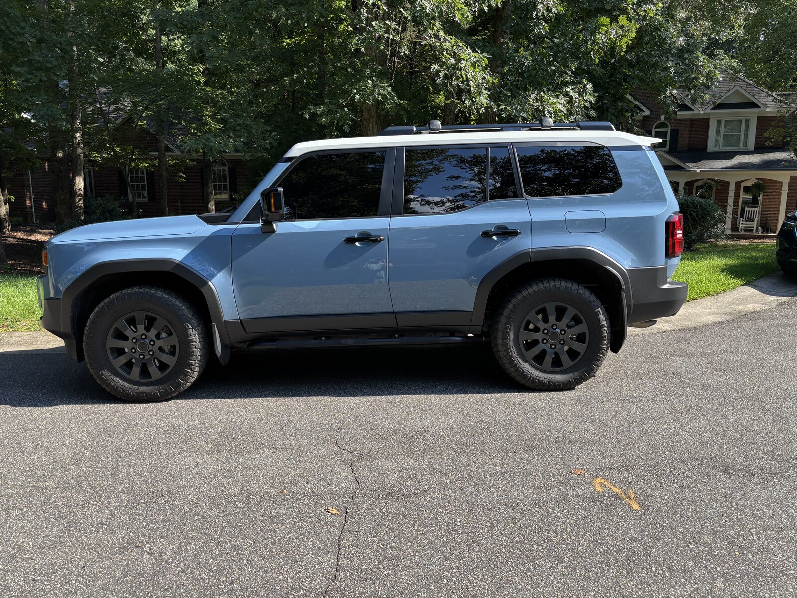

Well just ordered this kit from Performance Lifts and am very excited to get it in and installed. I’ve had my LC for about a month and it’s on factory 18’s with Nitto Ridge Grapplers.
Going with 17” Method 703’s and Toyo 35x11.5’s.
Will post an after pic when done.
So here is the before.
