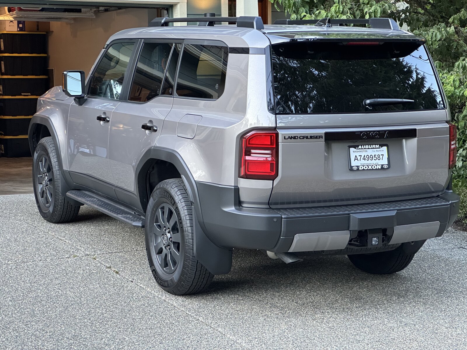

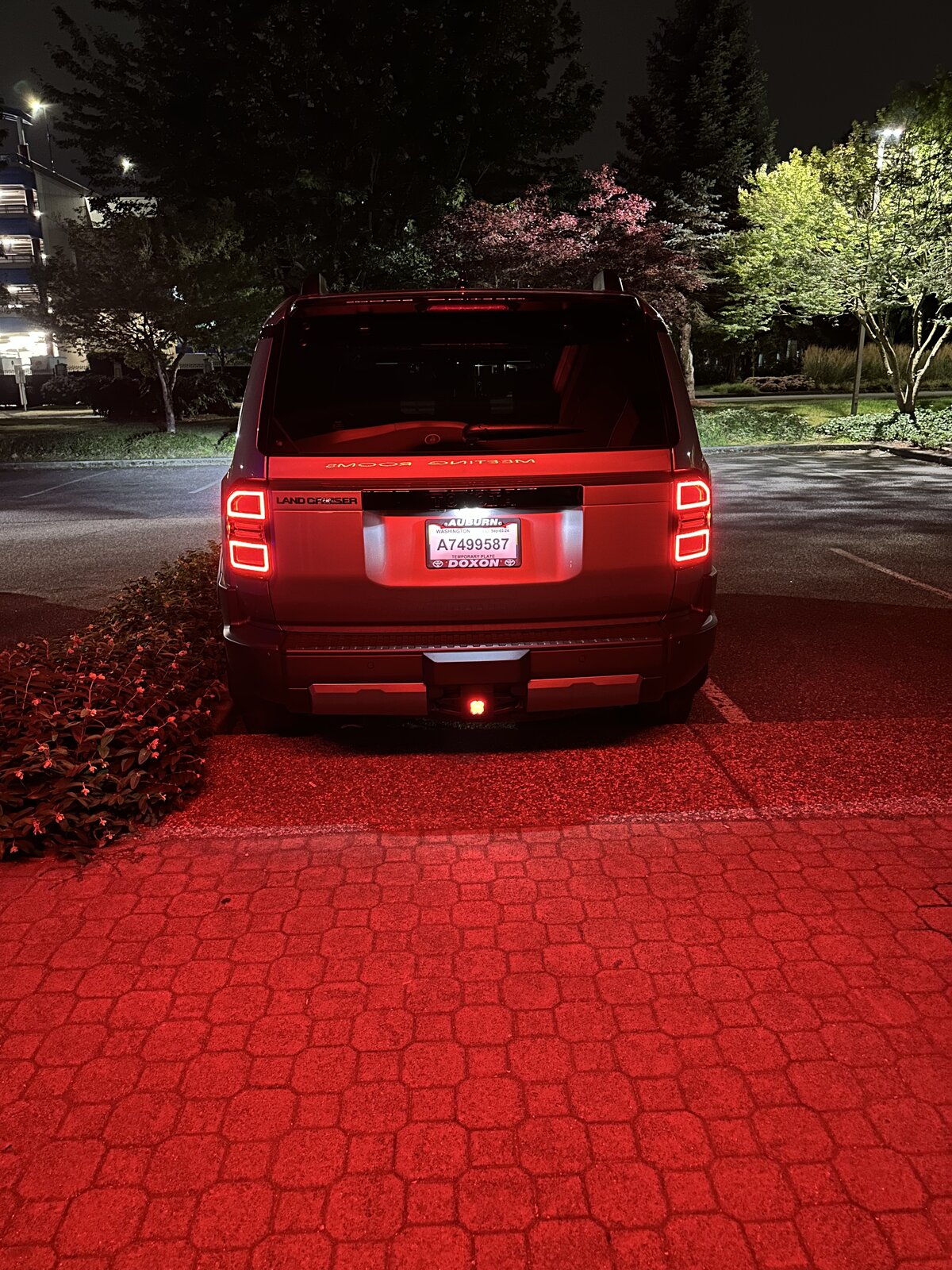

Two minute install. Probably could cut a hole in the diaper cover but this looks a little bit more rugged IMO.
I chose the brake + reverse. There's a cheaper reverse only version.

You can probably remove it in 30 seconds. Just depress the tabs on the side of the lamp housing and remove it from the hitch. Then remove the plug that goes into the back of it and use the rubber cover they include (it's attached to the harness already) to cap it off. Throw the lamp in the back somewhere and hook up your trailer.
Optionally if you're worried about theft, you can remove the tabs on the lamp housing and run a hitch lock through it.

They provide two options, just brake light or brake light/ reverse light combo. I purchased the combo and the reverse light is very bright. Really helps in rural areas.
