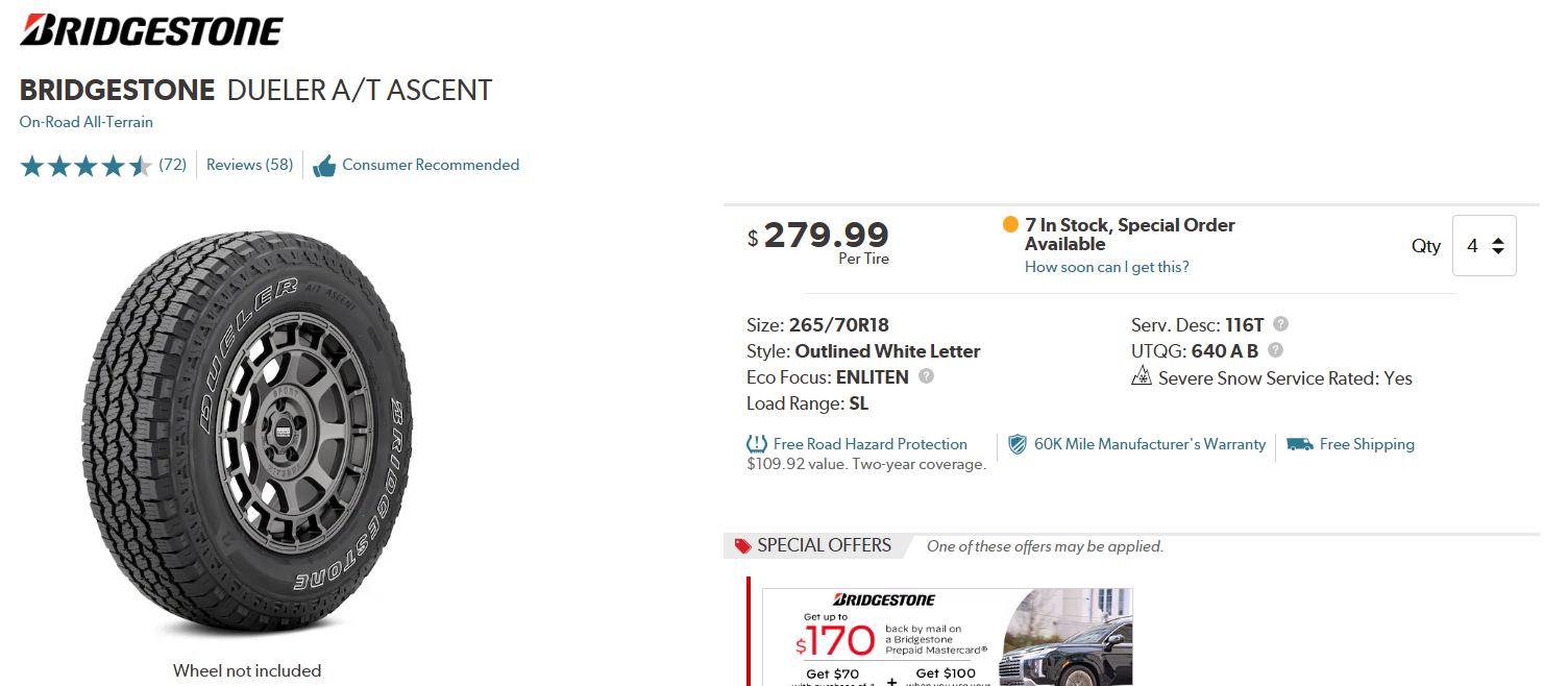

I have been enjoying the Bridgestone Dueler A/T Ascent in 265/70R18 size.
They seem just as quiet as the OEM Geolanders and I have only seen a 1-2 mpg hit in mileage at highway speeds.
These will be my next set of tires. Everyone says they are very quiet, and give a very good ride.
