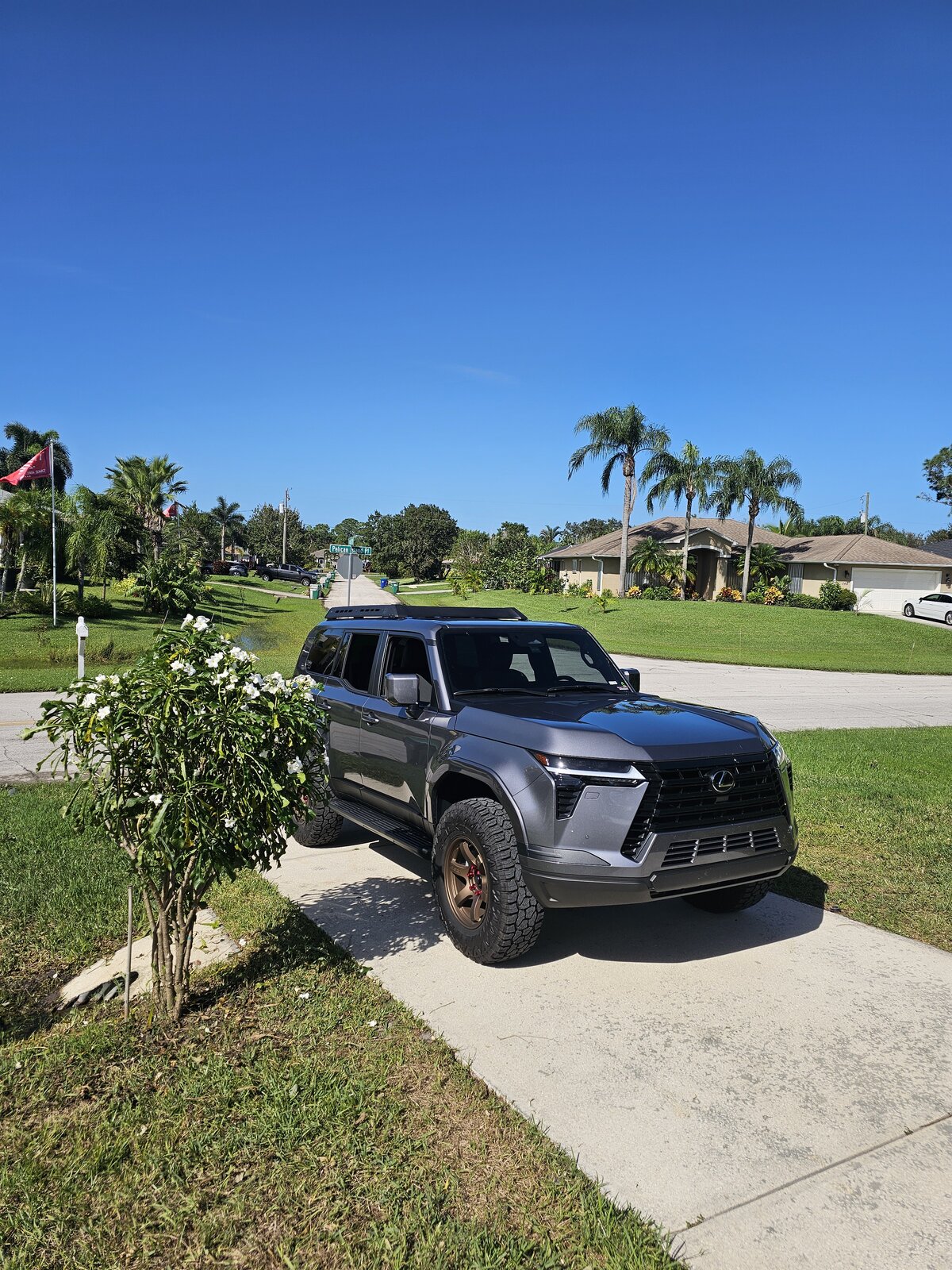

Will be parting with my rays soon.. 18x9 20mm offset on 35x11.5R18 Falken rt0-1 , but heres so you have an idea of fitment. I also have a two and a half inch lift
Will be parting with my rays soon.. 18x9 20mm offset on 35x11.5R18 Falken rt0-1 , but heres so you have an idea of fitment. I also have a two and a half inch liftView attachment 16402
The poke out is what i am trying to avoid with the 20 offset

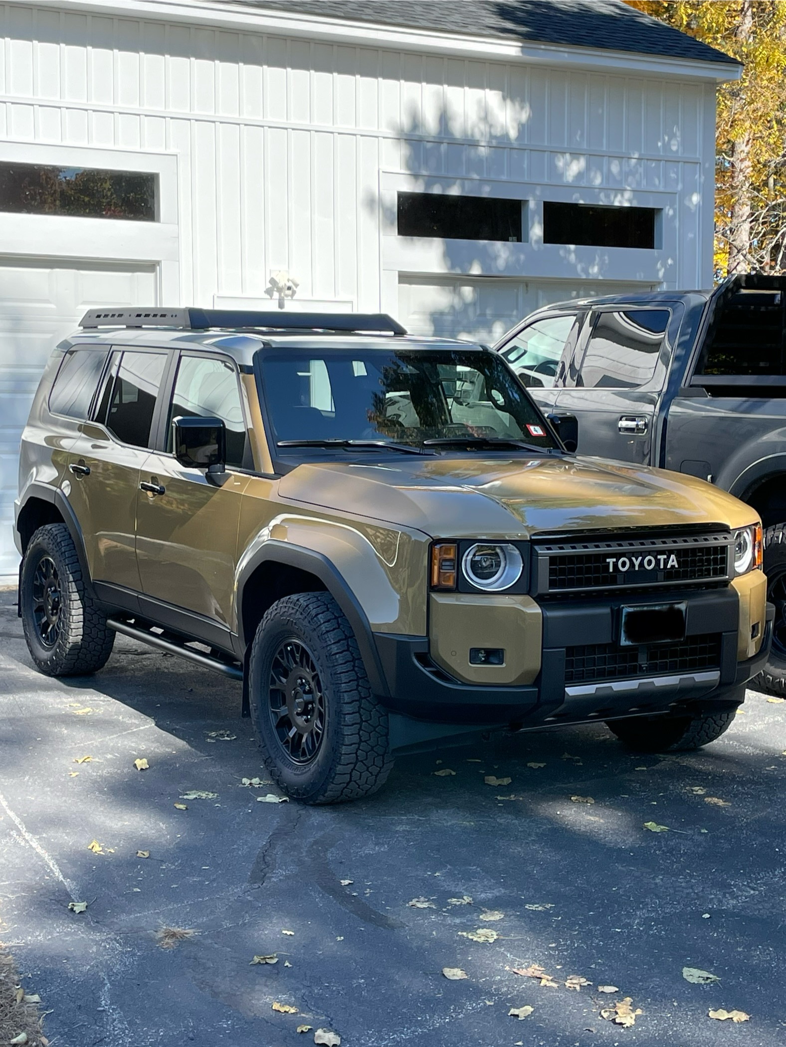

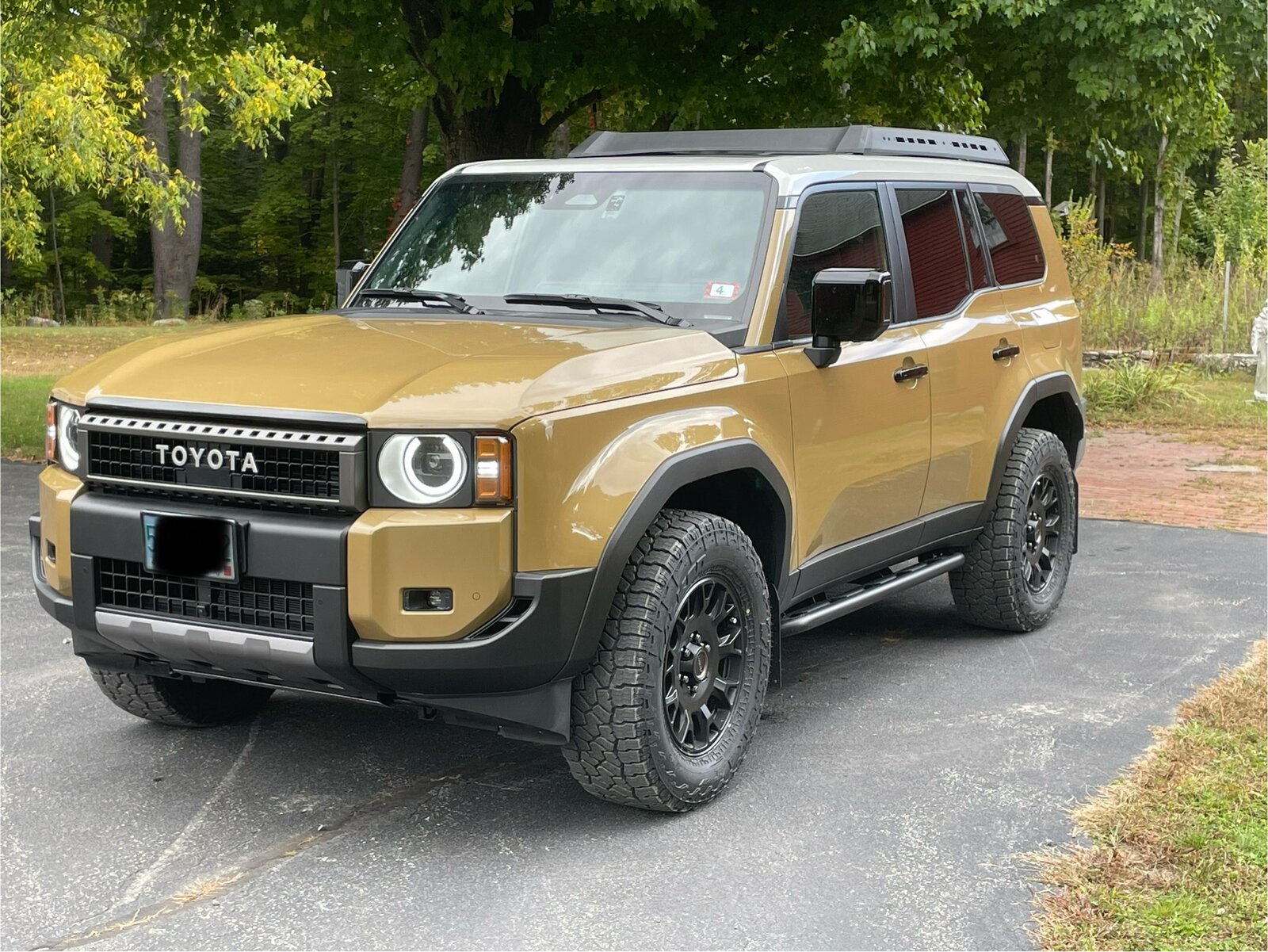

You'll have poke with +20offset. I have +45 offset with 285/65r18 tires and they just barely sit flush with top of fender flare. But it sounds like you are looking for a very specific wheel.
I am looking for bronze center with black trim with 40+ offset
Where did you find 45 offset?
Toyota Tacoma TRD wheel in 18" But I also have the Method 319 on order that should be arriving soon in Gloss Black 18x8.5" with a +40offset.
