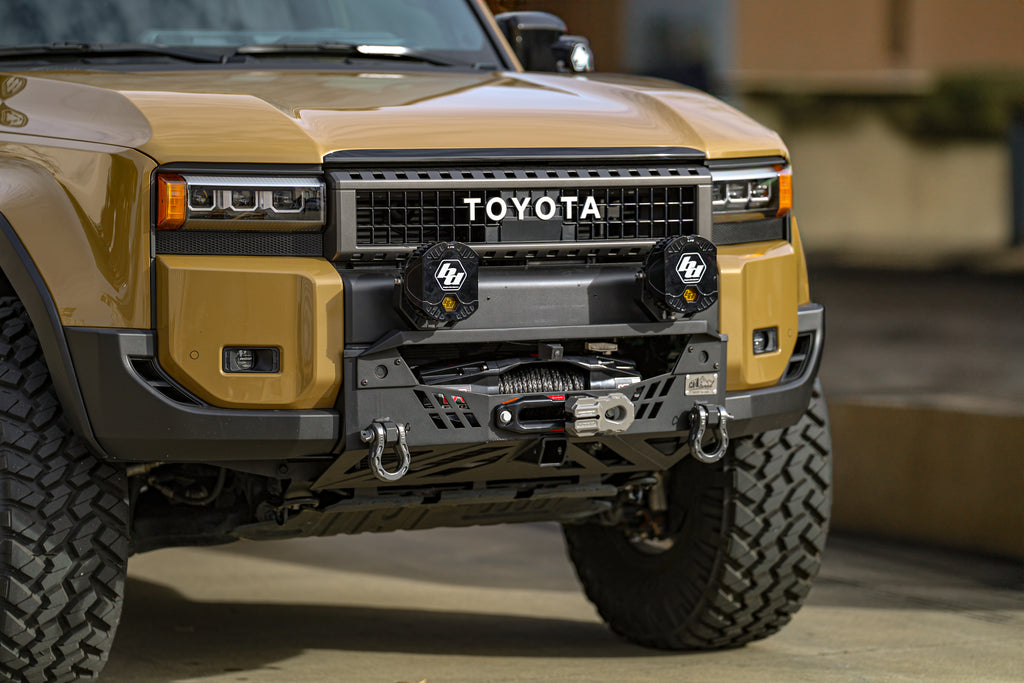

The folks at IronMan 4X4 are working on a lift kit (Foam cell shocks, HD Coils) and HD bumpers for the LC.They should be commercially available by June.View attachment 24815
I love the look of this bumper but hard to believe the radiator is getting proper air flow.
Good point. I believe the bumpers shown here are prototypes. It will be interesting to see how they design for that.

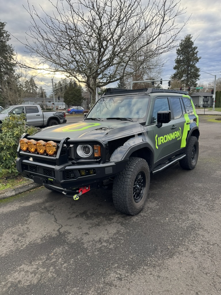

New full hoop by LRA - looks great!!

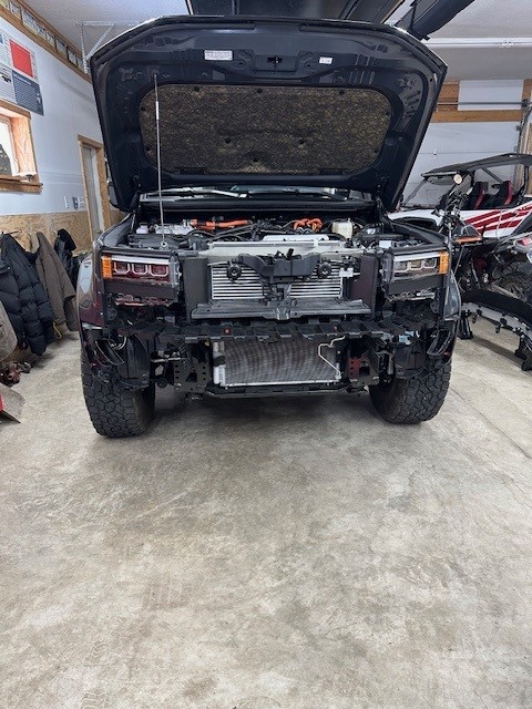

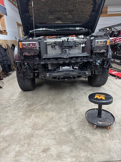

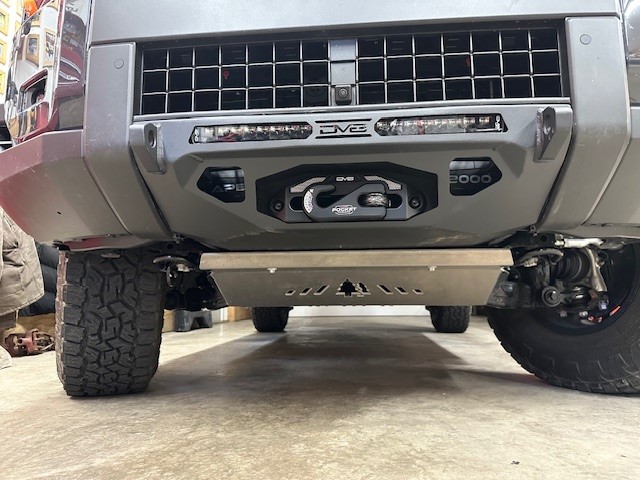

Installed the DV8 front bumper with their 20" light bar and a 12,000 lb. Bad Lands winch. Install wasn't too bad. spent most of the day and didn't hurry. This bumper works perfect with the Greenlane skid plate. Still waiting on the Expedition One rear bumper with double swings. On order since 1/6/25. Last update was shipping late April.

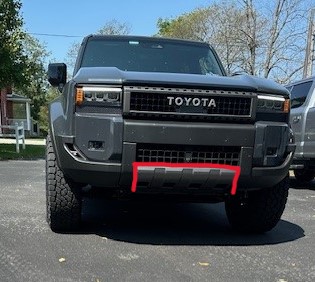

Does this DV8 bumper remove any of the original protection or crash bars ?
Their website mention ''Minor cutting is required for installation''. What as to be cut exactly ?
Their website mention ''Minor cutting is required for installation''. What as to be cut exactly?
The original internal bumper is removed and not reused. With the DV8 bumper, there will no longer be protection outside of the more narrow bumper. So basically under the headlights, there is no longer any protection there.
Cutting is pretty simple. With a sharp utility knife just cut away the silver portion of the lower grill. There is a bit of a groove on the backside of this grill and cut right along it. See RED cut line below.
Ok thanks cobweb for the info. I have to say that losing the internal bumper is a bit of a turnoff for me...

I have the greenlane skid plates too. I was also eyeing thr DV8 bumper and am glad to hear it works with the skid plates. Awesome!
