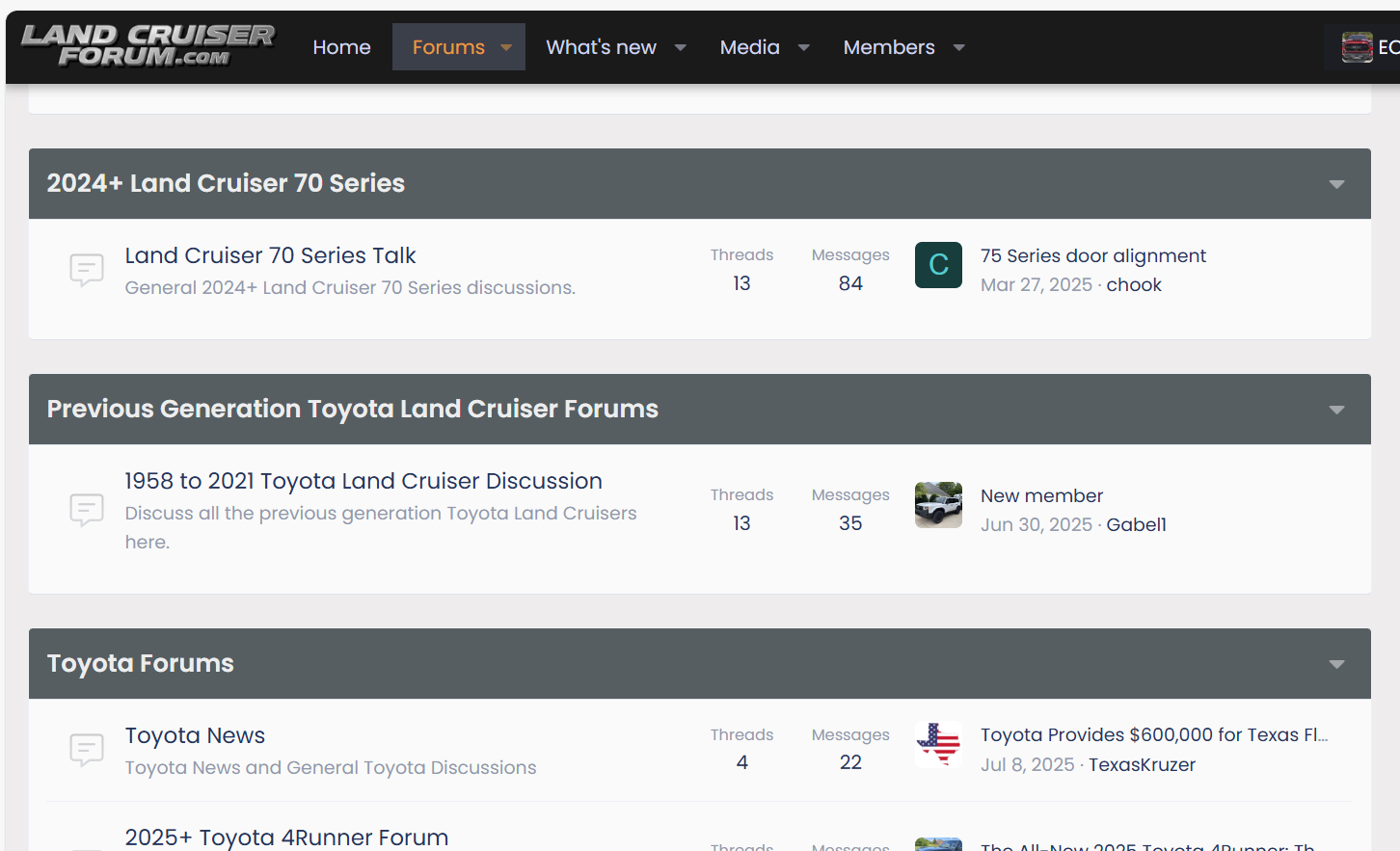

Welcome to the Jungle!
I can't answer your question as I'm not familiar with the 80 series.
You might get better answers on the older LC forum......
