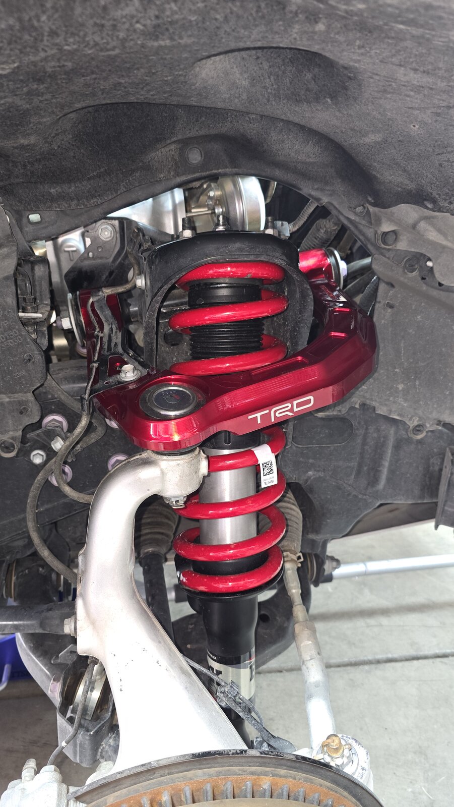

i've been entertaining the idea of the Trailhunter suspension and glad to see it all bolts in. makes sense it should! the TH UCAs will look so good on my Meteor Shower LC :love:
Since the TrailHunter shocks don't have an adjusting knob on them, they should bolt right in without removing the bump stop components.
I have the the ARB MT64 shocks on my GX550 OT, waiting on the TrailHunter upper arms. I assume the MT64 shocks work about the same as the Trailhunter ones.

These are the part numbers I ordered for the TRD Pro parts:
Front Fox TRD Pro shocks
PTR61-89250-RF
PTR61-89250-LF
Rear Fox TRD Pro shocks
PTR61-89250-RR
PTR61-89250-LR

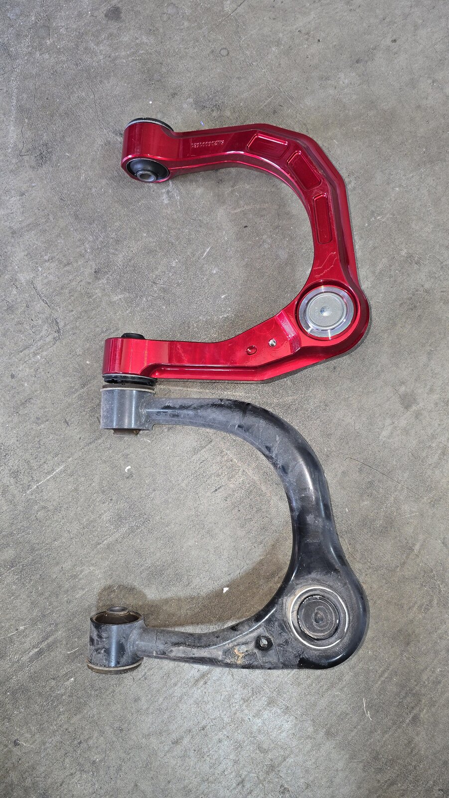

Front TRD upper arms (still need to check these fit)
48630-0W010
48610-0W010
I believe these are the TrailHunter part numbers, but do you own research.
Front OME\ARB TrailHunter shock (I think this works on the left or right side)
PTR13-89250-FR
Rear OME\ARB TrailHunter shocks
PTR13-89250-RR
PTR13-89250-RL
Front TrailHunter upper arms
48630-0W020
48610-0W020
