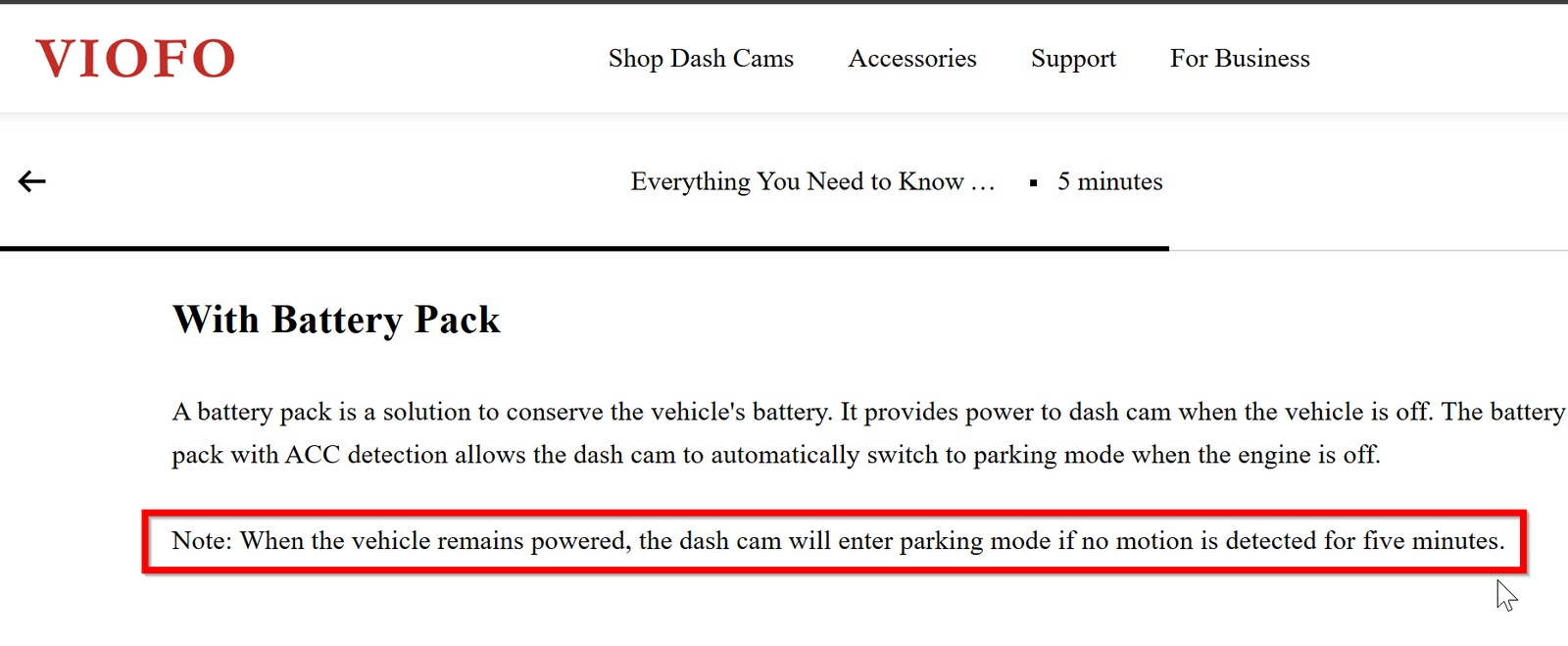

The DONGAR rep told me the Dongar Pro will not work with Viofo dashcams. Viofo "looks" for their proprietary parking mode connection. A separate hard wire kit connected to the dashcam. I haven't installed my camera yet. Trying to figure out a way to make a connect between the dongar pro and the Viofo hardwire kit.
FYI it does work. To clarify what our support guy means, is that the default low-data / low-framerate 'parking mode' can only be triggered from a Viofo hardwire kit. With our PRO adapter the Viofo's will continue to run in full recording quality after you park your car. Our kit will still shut off power to the dashcam after the timer has elapsed or the low-voltage threshold is met. The downside is that your SD card will fill-up a little sooner... e.g. the Viofo hardwire kit will tell your dashcam to record in half quality and therefore hold twice as much footage.
We actually know the Viofo guys out in China and they've told their customers parking mode will turn on when the camera's accelerometer does not detect motion. E.g. if you used a Dongar PRO (or 3rd party battery pack) with Viofo, it'll enter parking mode after 5 minutes no matter what:
I was disappointed to keep reading mixed results on this feature so I'm releasing a new product to emulate proprietary hardwire kits. The Viofo uses a non-standard USB-C by repurposing one of the data pins so its a non-trivial solution because there's no way of a USB power source knowing if a Viofo is plugged into the other side of it.
When I contacted both Viofo and Dongar, this was not the information I received. I'd be much happier with the combination of the Dongar PRO and the Viofo if I could get the A229 Pro to enter parking mode when my car is not in my garage. Can you help us understand the settings to use on the Viofo in combination with the Dongar PRO to get Parking Mode to work properly?
The partial solution I've been given is to set the Dongar PRO to the 4 hour on mode. However, as you point out, this will keep operating the A229 Pro in it's regular video mode, which will use a lot more memory.
Sorry, I didn't explain that very well, this was the information I received from your customer service. I won't get full functionality from the Dongar Pro when connected to the Viofo. I've already got the dashcam and the pro. If you're coming out with something that will work with Viofo and allow me to not have to "hide" their wiring kit I might hold off installing until your solution is released. I'tll also save me from experimenting to find my own wiring solution 😊.

You'll need support on Viofo's side (I can't speak to whether you'll get any case-specific inquiries because they're a huge company based in China Dongar is 3 fulltime guys in the US including me) because they say that their parking mode will enter via a timer when no motion is detected which would make sense for the many people who are keen on running their dashcams on external battery packs. But perhaps they backtracked to sell their hardwire kits (most likely because hey, its a business). What I can tell you is that the Dongar stuff follows a standard and legit USB-C implementation whereas they do not.... in fact you can take most dashcams from a China-based company and plug it into the built-in USB-C port in your Toyota, or even something like a MacBook charger and 85% of the time, it won't even power up because they don't do real power negotiation as USB-C standards require. Viofo takes the USB-C power pin used for power negotiation and repurposes it for their own use. So with our kit you could even power 12V items and fast charge an iPhone etc., have a robust setup with a Vantrue BlackVue, etc.
Nonetheless I've heard you guys and I'm coming up with a new solution for second half of this year. The technical challenge is that for a hardwire kit, there's no way of knowing what brand of camera or device is plugged into it, so we're giving you guys a very similar kit with user-adjustable parameters like voltage cut-off, adjustable timers, etc.
@uraniumrich I'll send you a PM with more information since it's not ready for public yet!
