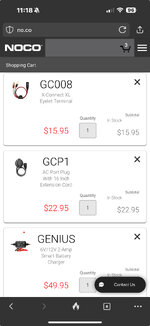

I can't say enough good things about the NOCO Genius GEN5X with the NOCO GCP1. In my GX, I did a lot of experimenting with batteries and charging before I switched over to using a Jackery to run my fridge. I made a mounting plate for it and tucked it away. It has a lead that bolts to the battery terminals. It just turned out so clean, and having the marine plug on the fender always made people curious.

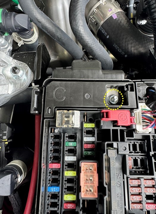

There are two easily accessible locations for attach a battery tender pig tail. I have a pigtail in each location.
The underhood Passenger's side fuse box. Using the existing stud located next to the "Jumper cable" connection point (yellow dashed circle). You can add another nut to the existing stud.

There are two easily accessible location for attach a battery tender pig tail. I have a pigtail in each location.

What size and thread nut does this take? Also do you have a recommendation for the black cable?
I think they were a 8mm (can't remember if it was a 6mm or an 8mm). I ran an 8 gage from both locations to resettable circuit breakers and attached the pig tails to the C/B. As far as the ground cable, I attached it to a fender bolt at the front and one of the jack cradle bolts in the rear.
