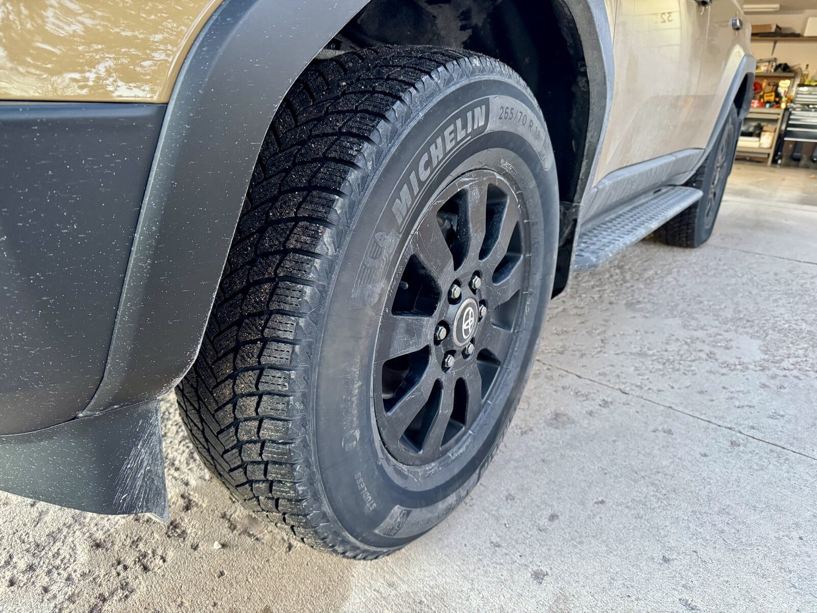

My go to Snow tire for years. Wear great, grip great, pretty damn quiet too. Can't complain about the Michelin X-Ice 3's on my Quad either. A bit more sport oriented. I am actua58lly glad my takeoffs are from a 1958 so in winter they tuck a hair more. Perfect for winter.
I’ll try to answer your question. Yes, there is a separate message that pops up on the multi media screen when no sensors are recognized. You’re then able to “dismiss” the message. The message pops up after about 20 minutes of driving. There is no beeping so I don’t find it annoying. The tires with the sensors are in my basement so I’m not sure if the lc picks them up when I park in the garage and that’s why the message continues to pop up every time I leave the house. I don’t think I have ever had that message when I leave my workplace. I have hundreds of notifications about the sensors. Funny thing when I leave the house and go in the woods and drive slow the message never pops up. I come from the generation where we glanced quickly at the tires every time we fueled up. Apparently the OEM sensors are treated like gold because so many people go through the expense of peeling the tires off, pulling the sensors, then replacing the tires before trying to sell them. I call that penny wise and dollar stupid. I run blizzaks 255/70/18 for the winter.

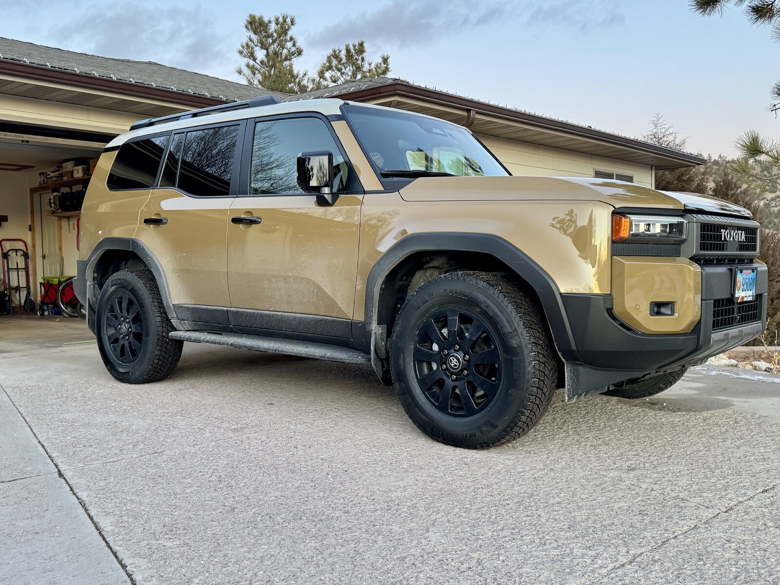

I've got two full sets with OEM TPMS: the original 20" with Dunlops for the summer, and some FE 18" I bought from an owner who switched them out upon delivery, on which I installed Terra Grappler G3s for the winter.
