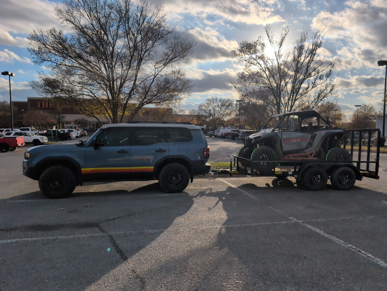

Not the best photos, but showing the new stance plus towing my SxS today. Besides improved handling and less (to no) nose diving when breaking, it also tows better IMO.
It does those things better because it is stiffer. The only tradeoff is it's harsher on washboard, but I'll happily trade that for improved dynamics in other ways.

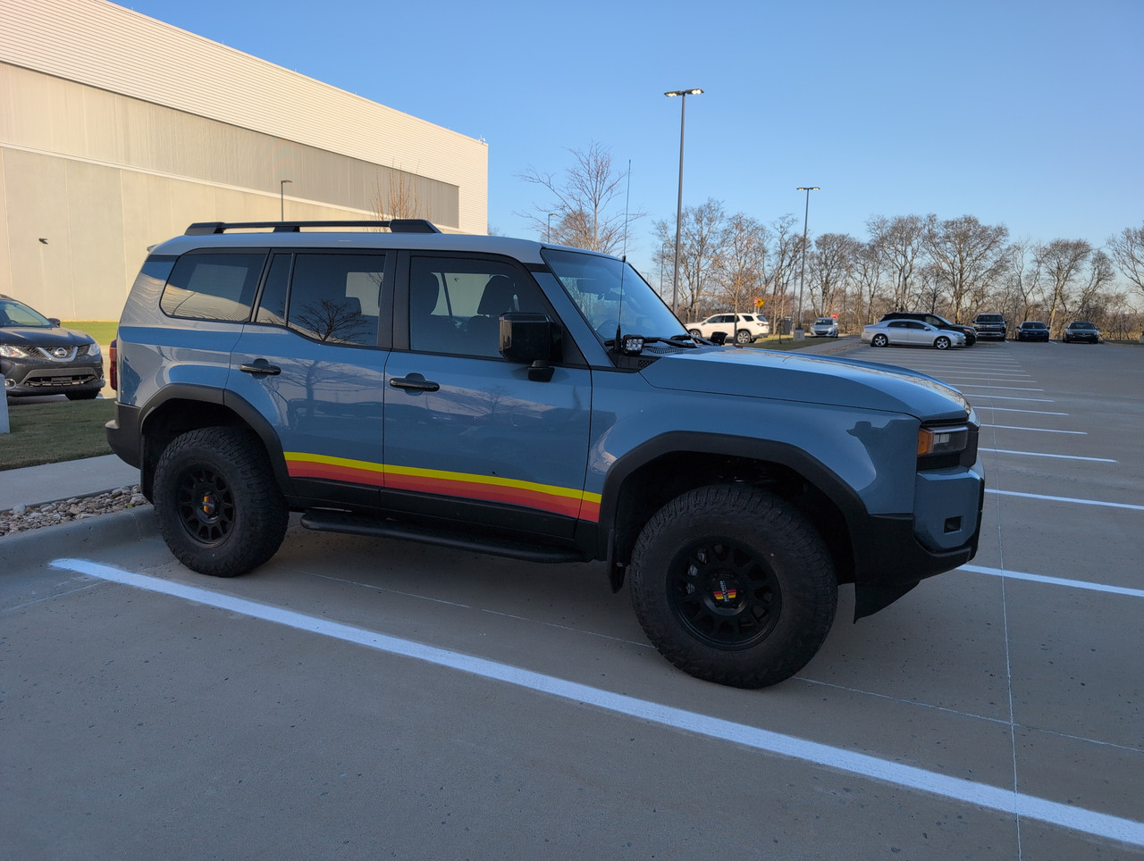

Had the All Dogs Offroad kit installed. Very happy with the results. Only pavement so far but rides very well.
